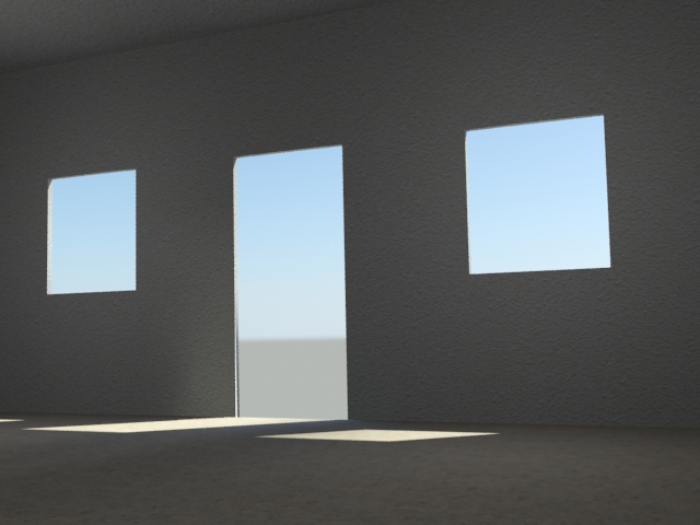

liv-k Posted February 28, 2010 Author Posted February 28, 2010 Well, I don't know what the problem is. You would have to post the file so that I could take a look at it on my machine. And yes, when you use the sky portals and increase the intensity it will get brighter outside. That's what's supposed to happen. What are you trying to render, inside or outside? If you're trying to render outside, then why are you trying to add lights inside? I'm sorry if I haven't been specific. I try to render inside a room. This is what my room looked like the first time I put the light inside and a daylight system outside. For some reason that I can't understand, now, with the same light inside and the same daylight system outside the render of the room is dark. At the previous post I mentioned that it gets brighter OUTSIDE when I increase the intensity of the INTERIOR light and I noticed that BEFORE I added the sky portals at the windows of the room. Sorry for being so tiring.. Quote
Cad64 Posted February 28, 2010 Posted February 28, 2010 Well, like I said, unless I can sit down with your Max file on my computer, I don't know what else to tell you. There is something wrong with your set up, but what it is, I just don't know. All I can tell you is just play with the light settings. Try different things. Try adding more than one light. Try different colors, intensity's, shapes, etc. Eventually you will figure out what's wrong. Below is a simple scene I just rendered. I have a Daylight System outside. inside the room I set up 1 Photometric Light in each corner. For each light, I selected the "100W Bulb" template, set the color to "Fluorescent (Daylight)" and set the Intensity to "1500cd". I left the shape as "Point". In the Environment and Effects dialog, I set the mr Photographic Exposure Control preset to "Physically Based Lighting, Outdoor Daylight, Clear Sky" and I set the Exposure Value (EV) to 13.0. I didn't do anything with my Final Gather settings, and I left my render settings on low quality, but if I wanted to spend more time on this, I could brighten up the room even more by tweaking those settings. Quote
