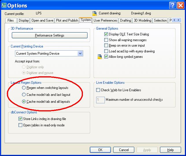

I have a problem with ACAD taking *way* too long--about 15 seconds each time--to switch between paperspace layout tabs. My file is about 20MB and I currently have about 30 separate layouts (with 10-15 more on the way). The worst part is it seems that the system is progressively getting slower and slower with each new layout I create.

4) Loaded my drawing onto someone else's ACAD2007 and it was still slow, if not slower. I also adjusted the Layout Regen Options and saw zero change in performance.

If available in LT 2000, try editing these settings in Options
Hi Ipseifert,
This route did not help me (see my Item#4 of tried and failed ideas above). The slowdown showed no impact, regardless of any of the 3 regen options I chose. Thank you very much for the suggestion, though.
