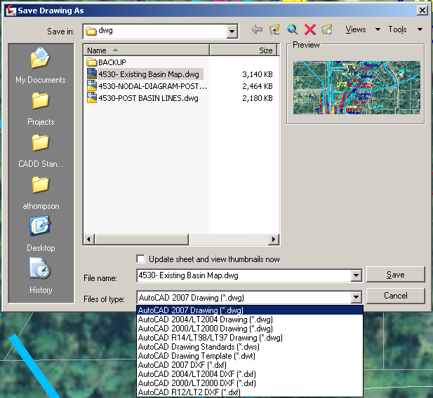

ReMark Posted February 23, 2010 Posted February 23, 2010 Just the way you did it but this time pay attention to the line that says Files of type. Sometimes users don't realize this resets to the current version. Quote

Coosbaylumber Posted February 24, 2010 Posted February 24, 2010 Just the way you did it but this time pay attention to the line that says Files of type. Sometimes users don't realize this resets to the current version. Only odd thing in this, is you MUST then exit, close or otherwise get out of Acad. Otherwise if you forgot something or maybe do something as innocent as a pan or zoom, it then overwrites what you saved, and reverts to the most current version of Acad. Thus you saved it, but who cares. Everything got saved as a 2009 version when you exit then. Wm. Quote
SFG13 Posted February 24, 2010 Author Posted February 24, 2010 I wish 09' had a drop down menu like the one you have Coosbaylumber. Thanks for the tip! Quote
