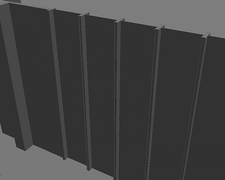

i'm using max 2009 and i got a problem in perspective view.
in picture 1, it's a space i've created, there is no problem at all in close zoom.
in picture 2, we can see a little scratches on the wall, but it's still ok. probably it's just normal for a thin wall in a very large area.
in picture 3, problem happens after i saved the file and open it again the next day, the whole scene is full of scratches. there is no affect on render output. but it's so painful to work it in pers view.
it's actually a model i've created in CAD and import it in max, whenever i import it again, it's ok (just like picture 1 and 2). however when i open it again a certain time later. it becomes crappy. is there any way i can fix this problem?
i don't have the max file in hand right now, probably i will upload it here later if necessary.
please help and thanks for reading.

Ok, I had a look at the files you sent and I have a solution for you.
1. Select your model
2. Right click and select "Object Properties"
3. In the Properties dialog, click on the "General" tab
4. Under "Display Properties", put a check in the "Backface Cull" box
5. Click Ok and your problem should be gone
I think what was happening is that some of your objects are very thin, so Max was actually viewing the faces as being almost overlapping. By enabling "Backface Cull", you are telling Max to ignore the backside of all poly faces, thus making them invisible and see-through from the backside.

i was having doubts on your answer that,
1) i understand why 20mm thick glass panel got this scratches because they are just way too thin to be displayed as 2 separate faces, but why my other walls with 100mm thick have the same problem.
2) why it looks quite ok while i just imported it in the max, and all the scratches come out the second day i open the same file.
3) i was thinking if there's anything to do with the light source, cos when i try to rotate the scene, the scratches seem to be interacting with the shadow/light.
so i did a simple test to save the max file in 4 different version.
i)the imported objects with backface cull and 1 light source
ii) the objects with backface cull without light source
iii) no backface cull with light source
iv) no backface cull no light source
and i found that there's nothing to do with having light source or not. the 100mm thick wall is relatively better than 20mm thick (less easier to have scratches), but they both got the problem when zooming out, as they are both considered 'thin' at a far distance.
but the problem is all solved when i turn on the backface cull. everything you saying is true. thanks for the advice again.
remark: when i first turn on backface cull, the scratches in the scene doesn't go away. now i know that i have to reopen the file in max to see the changes happen.
