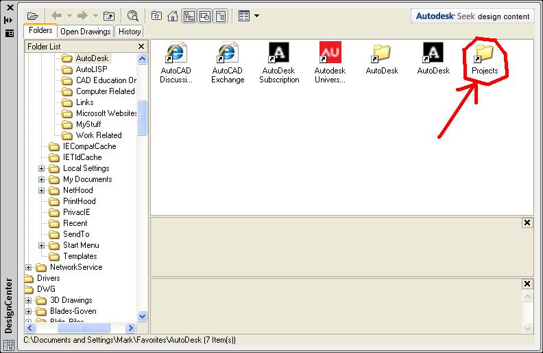

ReMark Posted February 24, 2010 Posted February 24, 2010 I tried to reproduce your problem but failed. I too have a Projects folder. I went to the location on my hard drive where the folder is stored. I right-clicked on it and selected Add to Favorites. I then went to the top of the Design Center window, clicked on the Icon for Favorites and in the Content Window there was a shortcut to my Projects folder along with shortcuts to AutoCAD Discussion Groups and AutoCAD Exchange, etc. Try again. Maybe you missed something. BTW...I was even able to delete the shortcut to the Projects folder via the Organize Favorites option. Quote
