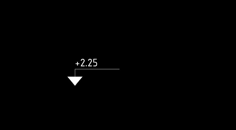

Hi everyone, I need to make my dimension to look the same as in the picture. I'm stuck in dimension styles. I dont know if I can do this in 2007 version.
Thanks a lot

I got the picture from a friend for who I am drawing the project, but he does not know autocad.
I got only this far. As you can see I have no + or - in front of them, the numbers are above and not on the right, I have no short line on the right and no line under the black datum triangle.
And there is another thing, I do not know how to set the coordinates for the house to get the -50 for example nor the -+ 0 .
Thanks
I think you are probably best using the qleader command, if you aren't already and then just editing you text to say what you need it to say.
As far as getting your co-ords set your datum to point 0,0,0 on the drawing and then work from there.
Another option would be to make the arrow portion a block and the elevation an attribute. When the block is inserted you'll be prompted for the value of the attribute. Something like this:
