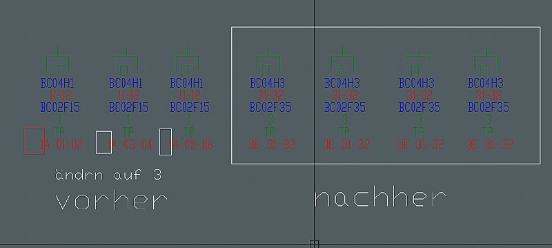

dober Posted February 25, 2010 Posted February 25, 2010 Hello I need to replace it with an attribute "1A 01-02", the 1 to 3. Search and replace it is unfortunately not. Please help Thanks Hallo Ich muss bei einem Attribut "1A 01-02" die 1 mit 3 ersetzen. Mit suchen und ersetzen geht es leider nicht. Bitte um Hilfe Danke Quote

dober Posted February 26, 2010 Author Posted February 26, 2010 Einfacher Textstring aktivierenSuche nach Text 1 und ersetze durch 3 Haken rein bei Blöcke inklusive Attribute Gesamte Zeichnungsdatei aktivieren und OK Ab geht die Post Unfortunately not. look at the picture at times. leider nicht. schau mal das Bild an. Quote
cad4fun Posted February 26, 2010 Posted February 26, 2010 The first 3 lines of Text are ok, isn't it? The fourth line is extraordinairy. I see '1A 01-02', '1A 03-04' and '1A 05-06' changed to '3E 31-32'. Normally it's impossible to do this with the Lisp-routine. Is it possible to send your DWG to helmut51@gmx.at? @tiger: sorry, i can't translate babelfish! :-) Quote
dober Posted February 26, 2010 Author Posted February 26, 2010 The first 3 lines of Text are ok, isn't it?The fourth line is extraordinairy. I see '1A 01-02', '1A 03-04' and '1A 05-06' changed to '3E 31-32'. Normally it's impossible to do this with the Lisp-routine. Is it possible to send your DWG to helmut51@gmx.at? @tiger: sorry, i can't translate babelfish! :-) Post is on the way Post ist unterwegs Quote
