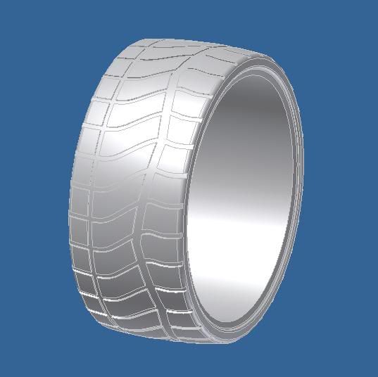

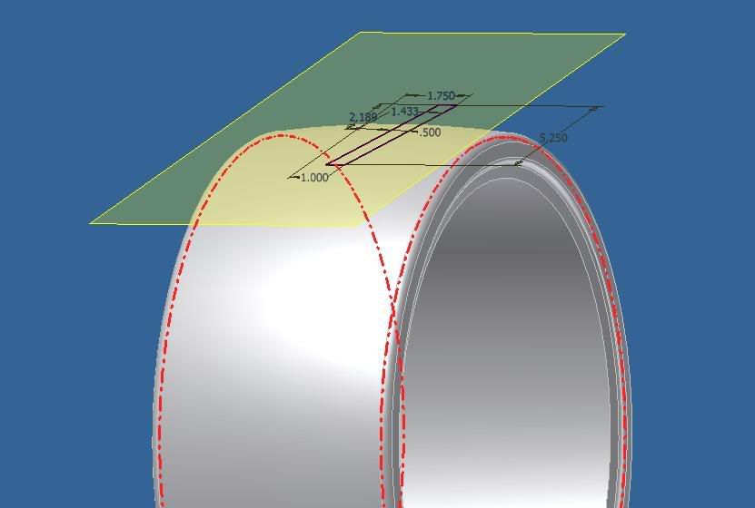

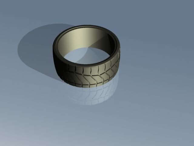

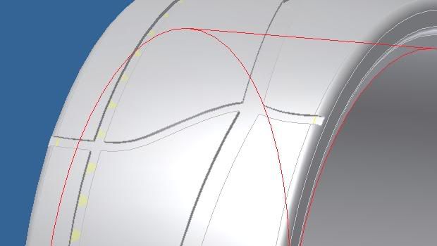

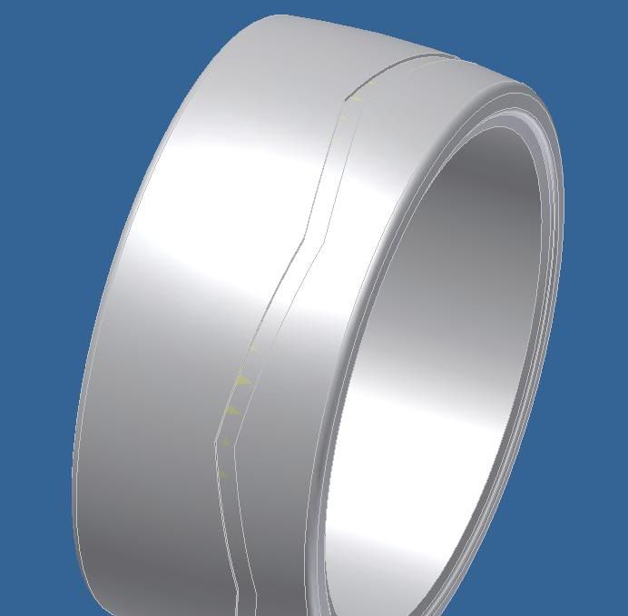

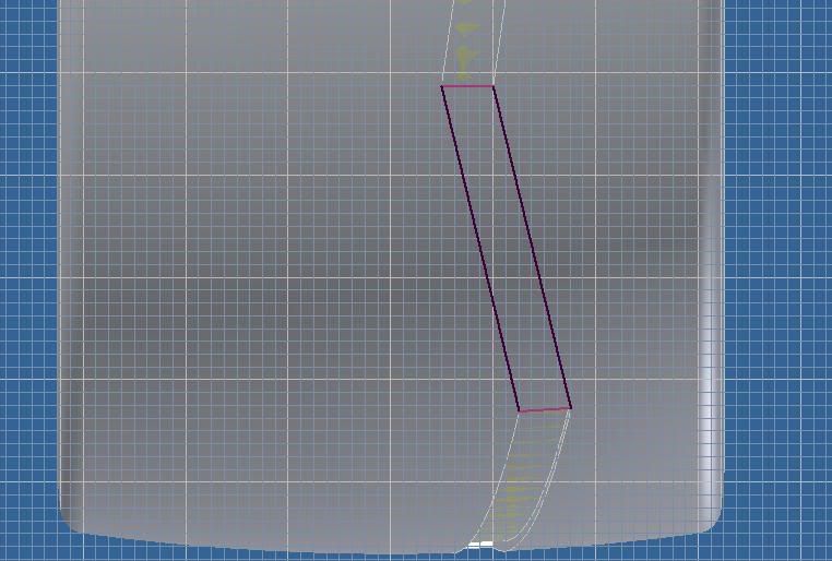

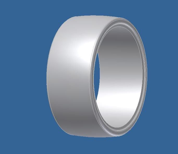

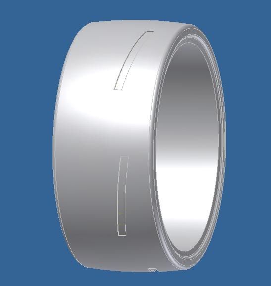

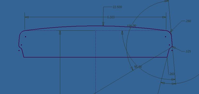

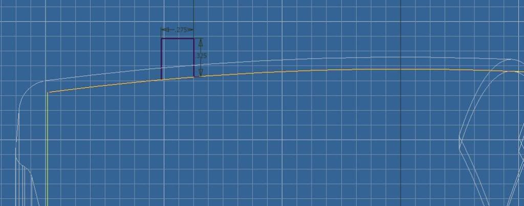

Alright here are some screen shots. Im not going to go into detail about each step because I am assuming you know how to properly sketch, setup sketch planes and dimension your sketches. If you have any specific questions about the procedure just ask. The profile was sketched, then revolved. An offset surface was created using Thicken/offset down into the tire(this is the "to" plane for the extrude/cuts and is highlighted by the dashed red lines in the 3rd pic). I created an offset plane to do my tire tread sketches. Firs was the zig-zag. I did an extrude-cut 'to' my offset surface. Circular array 5 times. Then i did another sketch on my offset plane projecting edges of two of the arrays and connecting them with lines. Extrude-cut, then array that 5 times and you should have a zig-zag around the tire. Next was the straight line all the way around the tire. I did this with a profile sketch projecting my offset surface and creating the rest of the profile. Then i revolve-cut this. Last was the "swoop" part of the cut away. Again extrude-cut this to my offset surface then a circular array(30 times in this case).
One important thing to note with extrude-cutting to your offset surface. This surface goes around the entire tire. You will need to use the "more" tab on the extrude pop up window and select "minimum solution". If you dont the cut will go through the tire and to the offset surface on the other side.
Hopefully the screen shots give you a little insight into one method of drawing the tire. Of course i could do this other ways by projecting paths onto my offset surface and doing sweep-cuts or any other number of ways im sure. The benefit of the sweep cut is being able to round the corners slightly without having to fillet. Not a huge procedure when using rule fillet but could be a time saver depending on the design intent.
