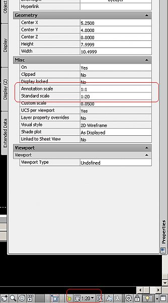

Here's two ways, if you select the viewport...
Another option is to pick the scale off the dropdown list on the Viewport toolbar.
And from the Command Line:

If you had picked it off the toolbar you would have been done by now. LOL
