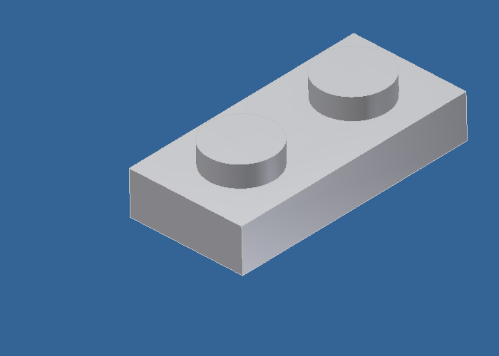

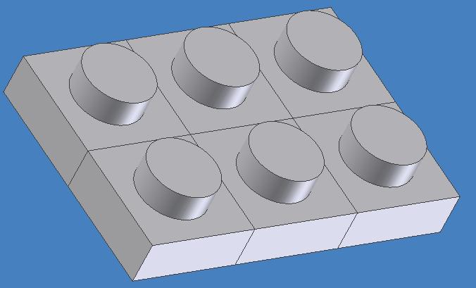

How do I get rid of these lines?
I'm drawing legos

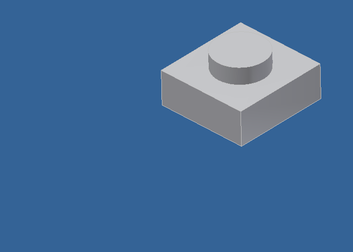

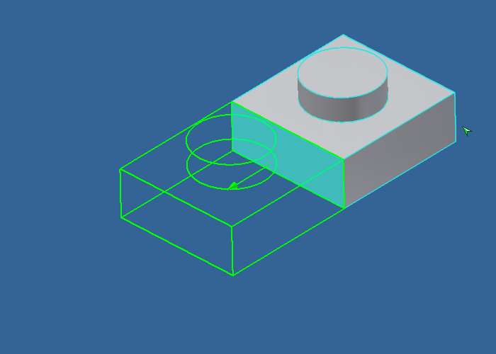

I drew 1 block then stuck many together to make other lego pieces
How do I get rid of the lines?
If it is an assembly you can't but you can just array your block to make a single block
Just make a single part file for each lego shape then assemble them just as you would real lego's
If you have 2010 I believe you can combine multibody parts into one but I don't have that version so can't verify that.
KC
Try Tools>Application Options>Display tab and uncheck Edge display. Or model correctly as indicated by kencaz.
