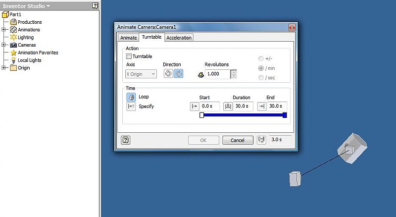

Attach your file here. Did you find Turntable animation?
Here is the general idea to what I think you are getting at. When you start Inventor Studio you can create a camera. This camera can be rotated 45 degrees(if that's what you are looking for). You can right click on the camera and Animate Camera. In the animation window there is a tab for Turntable which will let you setup how you want the camera to rotate, about what axis, speed and so on.
Its really very straight forward to setup. Tweaking render settings, materials and lights will be way more involved depending on the quality of output you want.

The last time I attempted it, I was able to get the video to pan back and forth (but I wanted it to rotate 360°).
If I still can't get it to work correctly, I'll do an upload.
