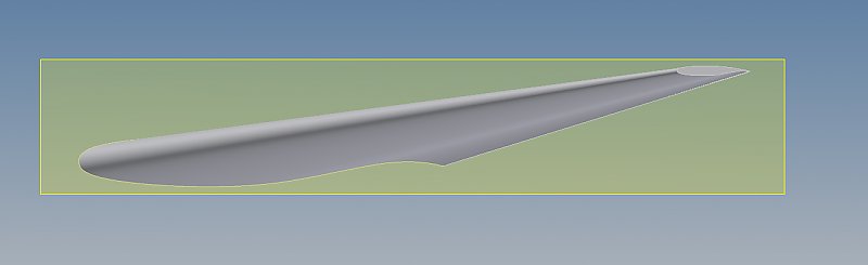

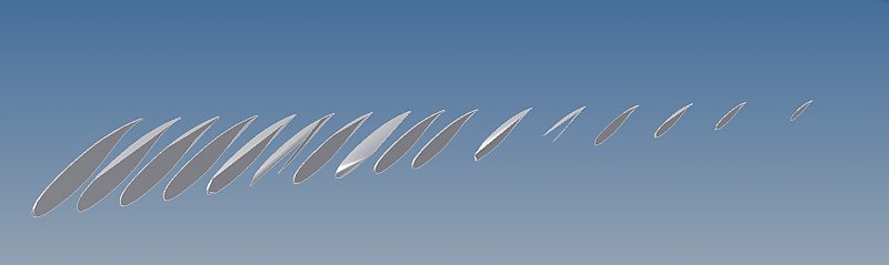

I am trying to create the rib structure of an aircraft wing. For FEM reasons, it's best to create as a single component. However, the simplest process for creating the feature gives some very strange distorted results.

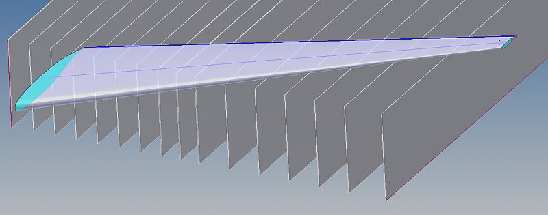

I have created a series of spaced plates of appropriate thickness for my ribs, I have the root airfoil sketched on one endplate and the tip airfoil on the opposing endplate. Ideally, I would loft these two sketches using the intersect selection which would result in correctly spaced ribs of the correct thickness. However, when I do this, the ribs come out distorted, for lack of a better word. All of the ribs have seemingly random and curved faces (see picture).
This problem also occurs if I do this process in reverse, i.e. loft to form the wing, then slice through to form ribs. I'm baffled and have not been able to find any solutions to this problem. Any help would be greatly appreciated.
If you just loft the foil without using intersect, does the shape come out right? it would appear so from the preview.
Yeah, the problems only arise when I try to form ribs with a lofted shape.

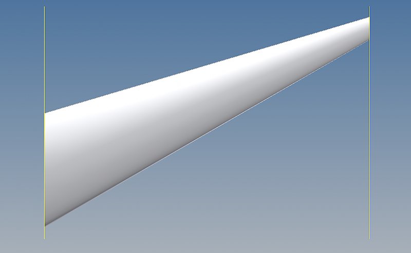

I have created the simple loft between root and tip airfoils for comparison, as expected Inventor forms the loft perfectly.

Your ribs are going to be as simple as offset outside surface in (what is the thickness of the skin?) and Sculpt or Split rib thickness (Extrude - Instersect might work as well).

Right now, I am modelling the wing without any skin. I have tried using the split feature yielding the same distorted results. My only guess here is that the relative dimensions of the ribs are too small compared to the overall wing.
When I perform the same process using ellipses rather than airfoils, this distortion does not occur. The file is also much smaller.
