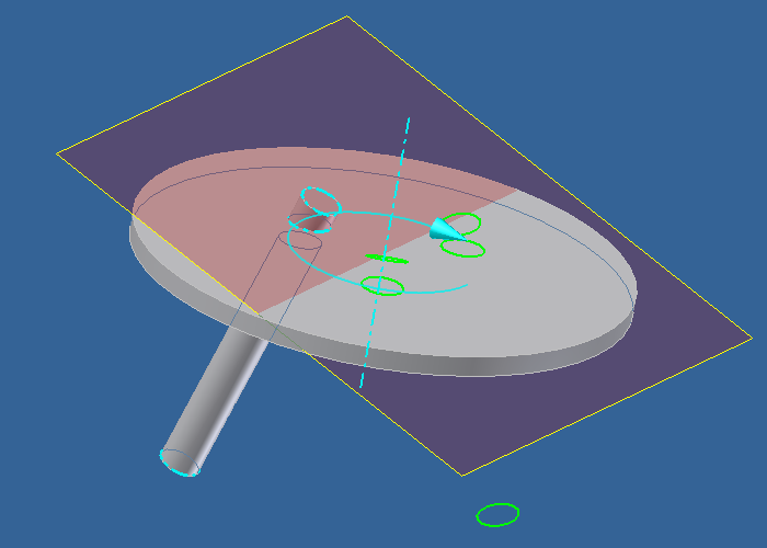

vertical horizons Posted March 10, 2010 Author Posted March 10, 2010 ...If it is just three holes in a circular pattern 18 degrees apart... The three holes' centers are on a centerline that has a 1.75"Ø that is in the center of the solid. The solid is round. The best way I can think of how to explain it is to take 3 pencils and put them perpendicular to a round table, with all of them pointing upwards. Then tilt the tops of the pencils away from the center of the table 18°. This puts the tops of the pencils pointing away, and the bottoms of the pencils pointing towards the inside. Basically, I need to know how to make several holes at an angle that is not on the X, Y or Z. Using the hole command or the extrude cut, I have to be on one of these coordinates. Quote

kencaz Posted March 10, 2010 Posted March 10, 2010 You mean kind-of like a tripod for a table. Here I created an 18 degree offset workplane to make the sketch and extrude for the hole. Then just did a circular array. I did not cut the holes so you could see better. You would of course use the cut option. KC Quote

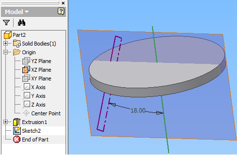

JD Mather Posted March 10, 2010 Posted March 10, 2010 Using the hole command or the extrude cut, I have to be on one of these coordinates. You can always sketch a rectangle at an angle (3-point rectangle or line-by-line) and then Revolve-Cut. Quote

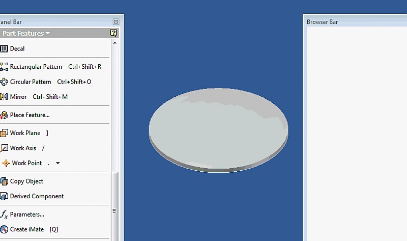

vertical horizons Posted March 11, 2010 Author Posted March 11, 2010 Thank you for the fast response. ...I created an 18 degree offset... How did you create the 18° offset? I have spent a lot of time searching the help section and also looking online, but to no avail. Quote

JD Mather Posted March 11, 2010 Posted March 11, 2010 See attached. Revolve-cut around the centerline side of the rectangle would do what? Quote
kencaz Posted March 11, 2010 Posted March 11, 2010 How did you create the 18° offset? You can use a surface as here or select the plane and axis from the browser. KC Quote
vertical horizons Posted March 11, 2010 Author Posted March 11, 2010 kencaz, I tried to duplicate what I saw in your video, but I am doing something wrong. When I choose WORK PANE, then select the X AXIS, I don't get a pop-up dialog box where I can enter an angle. What are you doing to get that dialog box to come up? ******************* Never mind this last post. I don't know what I did just now, but I am now getting the angle dialog box. You guys are the AutoDesk Gurus. Thank you so much. Quote
kencaz Posted March 11, 2010 Posted March 11, 2010 Select the plane first... then the axis. I used a surface so I did not need to select the plane... KC Quote

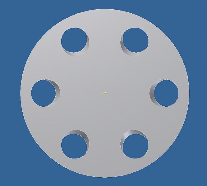

vertical horizons Posted March 11, 2010 Author Posted March 11, 2010 I have included a PDF showing what I am attempting to do. Hope this helps. 18 Degree Holes.pdf Quote

JD Mather Posted March 11, 2010 Posted March 11, 2010 ...to see if that will work. Of course it will work. This part is trivially trivially trivially easy. Let's go through it step-by-step. Start a new part. Sketch the 2 cicles and dimension as shown. (I don't know the 5" actuall dimension - change it to what it is supposed to be.) Zip and attach your file here for step 2. Quote
kencaz Posted March 11, 2010 Posted March 11, 2010 I just thought of a glitch with your solution. Being able to change the work plane to an 18° slope, I can now make the 1st hole. But, that 18° work plane will not work, as far as making the other 2 holes. I don't see the glitch? Doing a circular array, inventor will rotate the first hole feature around a center line including the 18 degree angle as pictured in Post #5. KC Quote
vertical horizons Posted March 12, 2010 Author Posted March 12, 2010 You want to cut a single hole through your part. Then you will do a circular pattern of that one hole as opposed to doing a pattern in the sketch... That did the trick. I thought that you could select "Circular Pattern" only while in Sketch Mode. Of course it will work. This part is trivially trivially trivially easy. Let's go through it step-by-step. Start a new part. Sketch the 2 cicles and dimension as shown. (I don't know the 5" actuall dimension - change it to what it is supposed to be.)... JD, Thank you for your help. Between you, Shift & KC, I have found valuable iinformation. Thanks again. I don't see the glitch? Doing a circular array, inventor will rotate the first hole feature around a center line including the 18 degree angle as pictured in Post #5. KC KC, You're right. There is no glitch. Just me not knowing what I was doing. Quote
