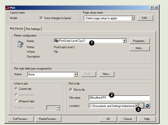

I am trying to follow a tutorial on here and got stuck
Can anyone tell me where I find this plot device/plot setting box in CAD? thanks for the help
If you're asking how to open that dialog box, just type plot at the command line. It may look a bit different in your version. The one shown doesn't look like the one I'm used to seeing in 2009. Can it be it's from 2010?
okay, yes I know how to get the plot box up but my box does not look like that one and mine does not have the options to choose a file source for some reason
Here is a screen shot of the plot dialog box from 2008. I'm fairly certain it's the same in 2009.

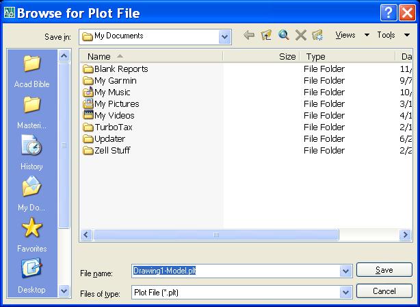

If the 'options to choose a file source' you speak of is the name and destination of the plot file when you have the 'Plot to file' box is checked (shown below as 'Browse for Plot File'), it won't appear until you hit OK.
thank you for the help, i guess the box just looks different and i can find it all in my plot box
