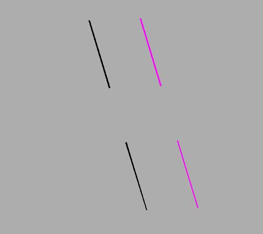

woodman78 Posted March 11, 2010 Posted March 11, 2010 I have 2 drawings. In drawing 1 a dashed line has a scale of 1 and looks normal. Drawing 2 is of the same road junction I am drawing and so the scale of the drawing is the same but when i paste the line in from drawing 1 I need to set the scale to 0.1 to get it to appear to be similar. What variables can be causing this?? Quote
rkmcswain Posted March 11, 2010 Posted March 11, 2010 MSLTSCALE, LTSCALE, PSLTSCALE if you are working in a layout, and the definition of the linetype in each drawing could be different. Quote
woodman78 Posted March 12, 2010 Author Posted March 12, 2010 No they are the same in both drawings. Quote

woodman78 Posted March 29, 2010 Author Posted March 29, 2010 Anyone able to tell me why the lines in both of the above drawings appear different?? Quote
eldon Posted March 29, 2010 Posted March 29, 2010 They don't appear different to me. I am not sure what you are doing, but a drawing that contains only one line should be a little bit smaller than 778KB. Quote
