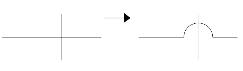

blagojer Posted March 12, 2010 Posted March 12, 2010 How can I do it? Like in AutoCAD electrical, when I drawing wire? Please see attach. Thanks Blagojer Quote
Fire_col Posted March 12, 2010 Posted March 12, 2010 I think you just need to draw and arc then trim the line, that's what I would do anyway. Quote
blagojer Posted March 12, 2010 Author Posted March 12, 2010 Yes, but I would like "automatic drawing"! Sometime, I have 200 lines without same distance (no copy-paste)!!! Maybe some LISP?... Quote
ReMark Posted March 12, 2010 Posted March 12, 2010 You would need either a macro or a lisp routine to accomplish the task. You want to insert an arc at the intersection then break or trim away the line segment between the two endpoints of the arc. Quote
dbroada Posted March 12, 2010 Posted March 12, 2010 updating to electrical would be the only way to do it automatically. There are ways you can do it afterwards as Mark has said. Whenever it has been requested of me I always point out how much longer it will take, both to draw and to modify and I am usually left to stick to the company standard. Quote
blagojer Posted March 12, 2010 Author Posted March 12, 2010 I cannot update to electrical, Mark has explaned what I want... Quote
blagojer Posted March 12, 2010 Author Posted March 12, 2010 I find LISP, but doesn't work, I have error: no function definition: DXF (defun C:arcc ( / head hdata bulge en ed) (if (and (setq en (entsel "\nselect polyline: ")) (= (dxf 0 (setq hdata (entget (car en)))) "POLYLINE") ) (progn (entmod (subst '(70 . 1) '(70 . 0) hdata)) (setq bulge (list (cons 42 0.5))) (setq en (dxf -1 hdata)) (while (and (setq en (entnext en)) (setq ed (entget en)) (/= "SEQEND" (dxf 0 ed)) ) (setq ed (append ed bulge)) (entmod ed) ) (entupd en) ) ) (princ) ) (princ) Quote
alanjt Posted March 12, 2010 Posted March 12, 2010 Yes, but I would like "automatic drawing"! Sometime, I have 200 lines without same distance (no copy-paste)!!!Maybe some LISP?... I cannot update to electrical, Mark has explaned what I want... I find LISP, but doesn't work, I have error: no function definition: DXF You can catch more flies with honey. (defun dxf (# e) (cdr (assoc # e))) Quote

rkent Posted March 12, 2010 Posted March 12, 2010 How can I do it? Like in AutoCAD electrical, when I drawing wire? Please see attach. Thanks Blagojer This lisp file will do that after the fact, the size is controlled by ltscale. PIDcross.LSP Quote

Ryder76 Posted March 15, 2010 Posted March 15, 2010 BTW if I wanted an ltscale of .4072 for the arc and then have it return to ltscale of 1 how would I modify the lsp to make it do that? Quote
rkent Posted March 15, 2010 Posted March 15, 2010 BTW if I wanted an ltscale of .4072 for the arc and then have it return to ltscale of 1 how would I modify the lsp to make it do that? Not entirely sure what you are asking. You want the arc to be a certain size that an ltscale of 1 doesn't give you now? The code has the arc size scaled at 0.1 * ltscale, this happens twice in the code at "(* LS 0.1)". This is really old code I obtained back in 1990 so I am sure it could be written much better today. You could change the 0.1 in the code, you could change ltscale on the fly to that amount, you could change the line in the code from (Setq LS (Getvar "LTSCALE")) to (Setq LS 0.4072) Hopefully that helps you, if not post back. Quote
