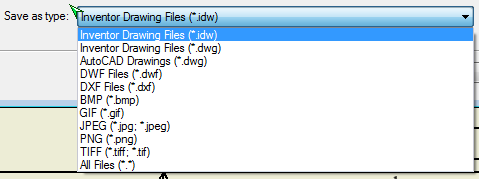

Why go to all that extra work? Save Copy As Type pdf. Done.

I don't seem to have that option in 2008 Pro. Is that new as of 2009 or 2010?

Oh ... my ... goodness ... I can't believe you can do that!! I've been printing to PDF and it's been a real pain ...
Thanks so much!
BTW, I'm on 2010 and the save copy as pdf is available. Not sure about 2008.

Inventor 2009 has this option.

I can't remember back that far, but are you in Save As or are you in Save Copy As? Two different things. If it isn't there (I think it is) I am almost certain you can add a pdf driver.

I cant do that either, but an ease way out could be to save a copy of your drawing in “save as type BMP“ zip it and e mail it
file>save copy as>save as type>BMP
>save in>my pictures.
Go in my pictures zip it and email it

Now, in 2015 version, you can just go to upper left most icon (Inventorlogo)>Export>PDF. Done.
