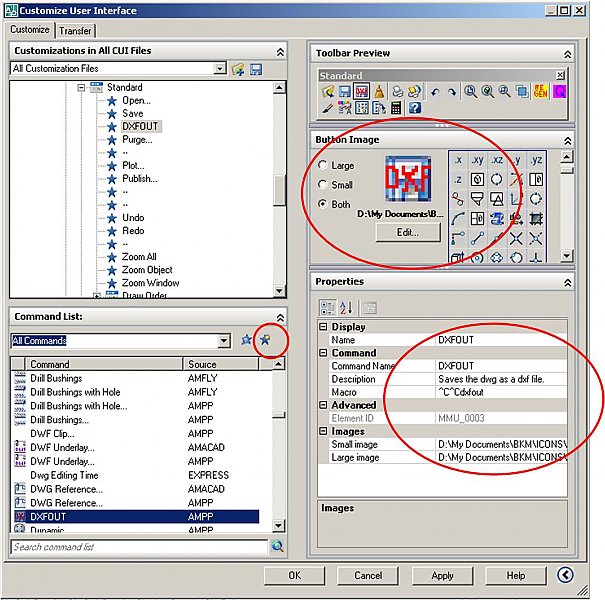

Is there no way of puting a DXF icon on my tool bar? I used to have this feature with 2008, but can't seem to get it to work on LT.
in the cui you can create a command and make a custom button to add to your toolbar.
Here is a screen shot...
