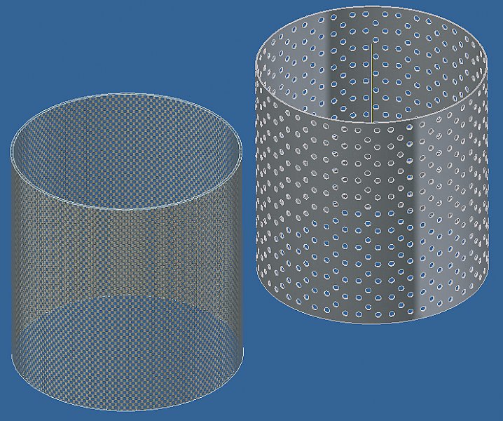

If you cut all the holes it will certainly tax your resources, however unless this is a pattern that will be flattened for a punch press or similar machine I would just apply a material.
The left part file using applied perforated materials is 155kb.
The right part file cutting the holes and only a fraction of what you need is 2MB.
So depending on what the file is for you can decide which is best.
