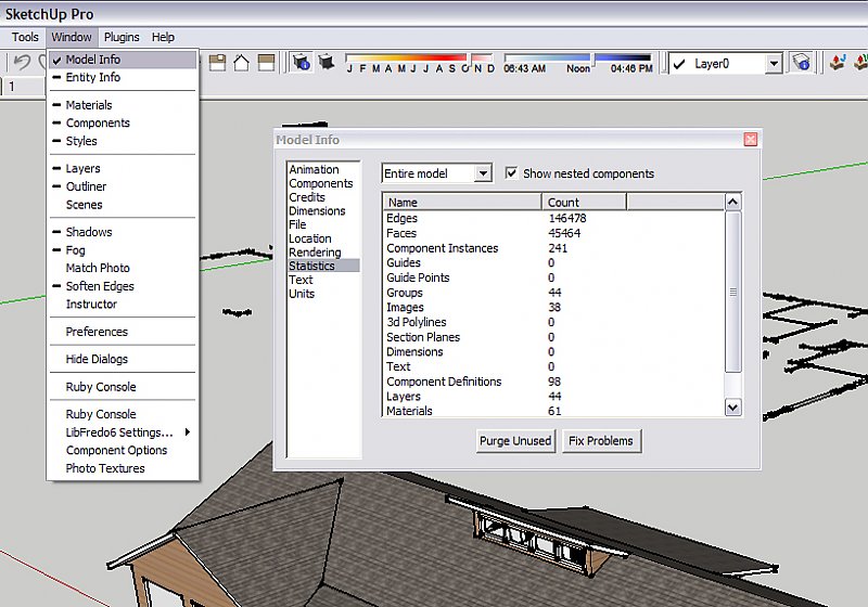

What is the polygon count?

Window Model Info Statistics
The faces number is what I am interested in seeing.

I looked over the model a bit and don't see anything wrong with it. It is a bit polygon heavy but I could not get it to crash while moving everything.
I did manage to purge quite a bit of items. See attached image. If you don't have it I suggest using the PurgeAll ruby script. It will purge everything in one step. I have attached it in a zip file. Just place it here:

After your suggestion above, asking for a faces count (for polygons), I went to the model and found 0 faces. I don't know how that makes sense, since I clearly have many faces in a drawing of that size.
Tim
That is odd. The model I sent you has over 45,000 faces. If you don't see what I do on your screen then there might be something wrong with your install. You could try re-installing SU and see if that helps???
As far as the poly count the windows and doors are very detailed. Were they imported from another program? If you could use components that are simplified that would help you out, especially if you are going to develop the model even more. Depending on the viewpoint you are going to present the model from you could use much less detailed windows and doors. Just a suggestion.

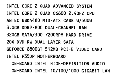

The fact that you are able to smoothly navigate the model without jerks and your faces count seems far more probable, still makes me wonder if video card or other hardware are the issue. May I ask the spec. and memory of your video card? According to another forum, my video card is only partially adequate for OpenGl and may be undersized.

Well Tim you are not in luck with me ha ha. I know the program pretty well but when it comes to hardware my knowledge is limited. Attached are the specs for my home machine. I also tested the file at work and it was a tad slower but I could move everything and had no crashes.
I suggest that you join the SketchUcation Forums and you will get your hardware help and even more software knowledge than I can provide.
