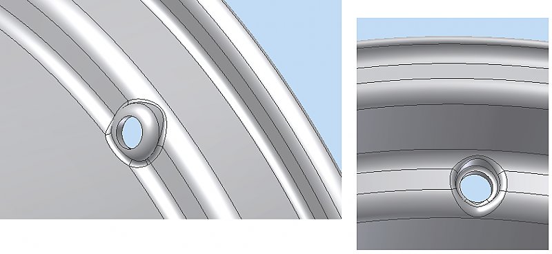

harley558 Posted March 21, 2010 Posted March 21, 2010 the attached drawing is of a wheel assembly. I have no problem creating the wheel and disc, my problem lies within creating the surface for the valve hole. That surface is actually an area that is 1.25 in. sq. and is pressed flat the depth you see in the section view. How do I acheive this and keep everything solid? a.dwg Quote

harley558 Posted March 23, 2010 Author Posted March 23, 2010 here is what i have done so far RIM.pdf RIM1.pdf Quote

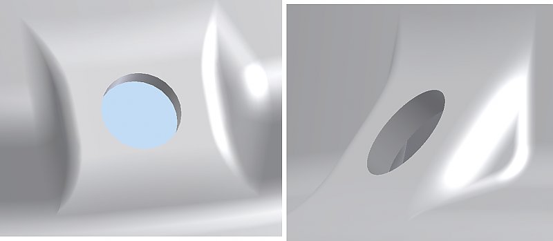

JD Mather Posted March 23, 2010 Posted March 23, 2010 here is what i have done so far I suspect that for the tooling a round punch would be less expensive, but here is the inside/outside view of what I was able to get using your latest information. The draft angle and fillet size could be adjusted if known. Quote

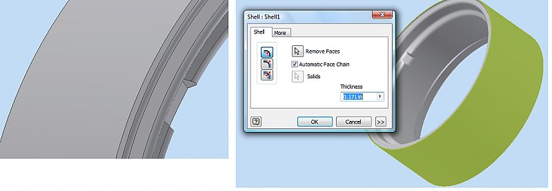

harley558 Posted March 23, 2010 Author Posted March 23, 2010 i know you told me the steps you used, what i am still wondering is what did you extrude to acheive this. i apologize if i am not totally following you on this Quote
JD Mather Posted March 23, 2010 Posted March 23, 2010 You start with a solid minus the bead. Model the outside. Shell creates the inside uniform wall thickness from the outside. Revolve the bead on the edge. Whenever you have a part that is uniform thickness (like pressed sheet metal) you only need model one side of the thickness and then Shell will create the otherside. Works for this part except for the hemispherical beads around outside edge of the rim - these can easily be Revolved after the Shell feature. Quote
