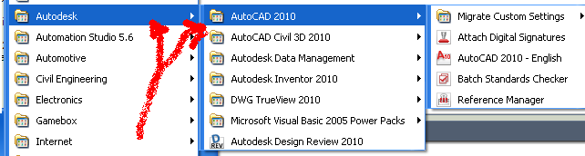

JD Mather Posted March 22, 2010 Posted March 22, 2010 If you go to Start>Programs>Autodesk... what does this screen look like? If you don't see AutoCAD Electrical you don't have Electrical. (I don't have Electrical) Doesn't mean you can't do electrical drawings - simply means you don't have the optimized tools for the field. Quote
ReMark Posted March 22, 2010 Posted March 22, 2010 Ok Thank you, I don't have it. Thus ends the mystery. Now what? Quote
