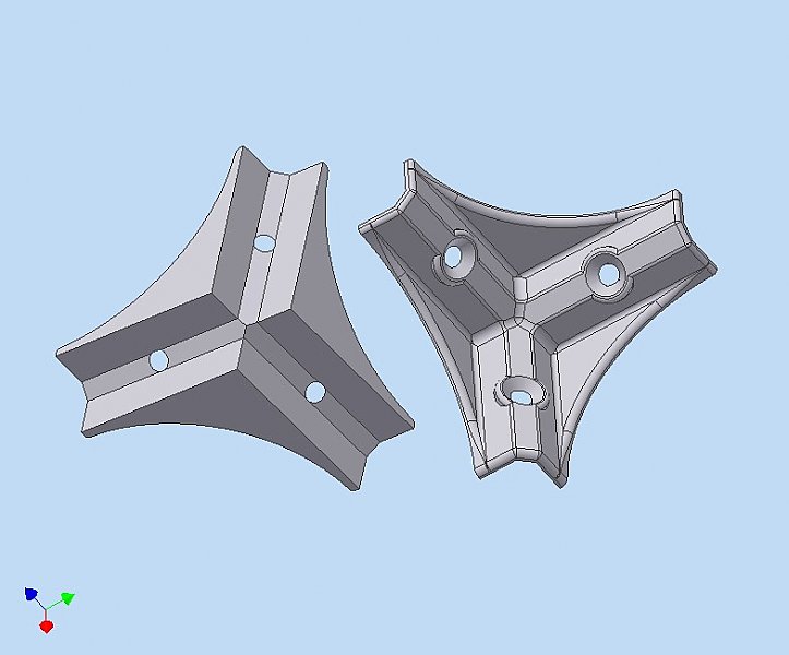

Hi there
I need a tutorial on die designing with odd parting line. The pic shows front and back of the thing I need to do
Is any one out there who can tell where I can get them?
Many thanks in advance.

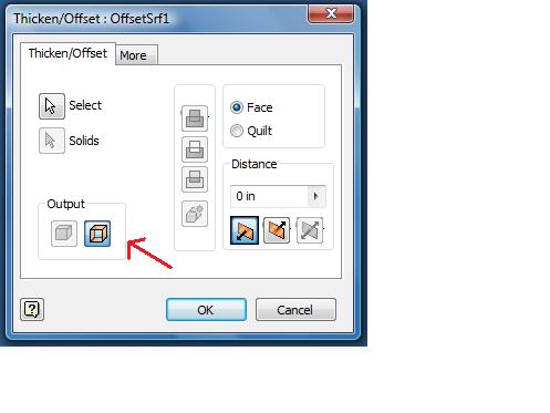

Thanks Shift. That would solve all the problems but the Thicken/Offset pop out did not accept the 0.
Is this the tool you mean?.

Ralf, maybe version 10 did not allow this. When you open the thicken/offset window you have to make sure to select the surface button. I have inventor 11 of my work computer so i will try to play with it today and see if it works. v10 and 11 were pretty close
zero offset works alright in inventor 11 as long as you select the surface button. I think the issue might be the surface/solid button.

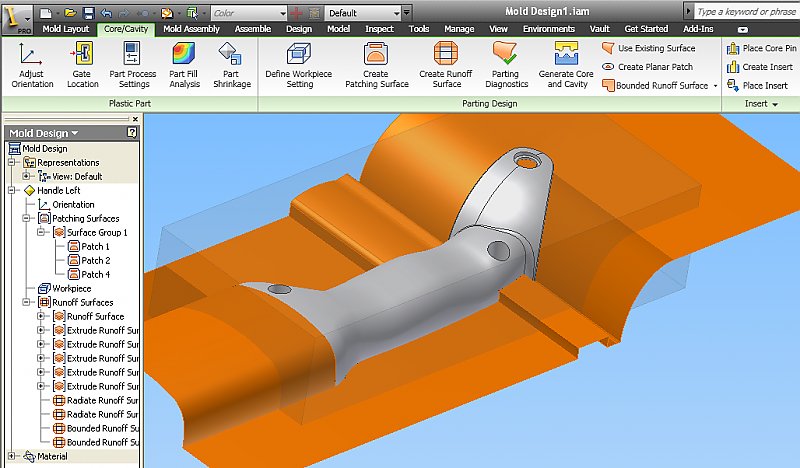

...never come across tooling and in the help index has nothing of the like.
Inventor Tooling makes creating parting lines and molds or tooling mucn easier. It is intended for plastic injection molds, but there is no reason to limit to plastic molds or even molds in general as with a bit of clever use it can also be used for general tooling.
I should point out that the shut-offs (patching surfaces) and run-offs (parting lines) were created either automatically or semi-automatically. These would then be used to split the core/cavity sides (translucent Workpiece body).

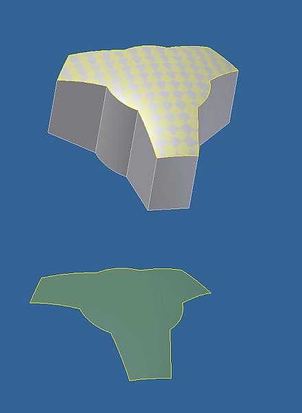

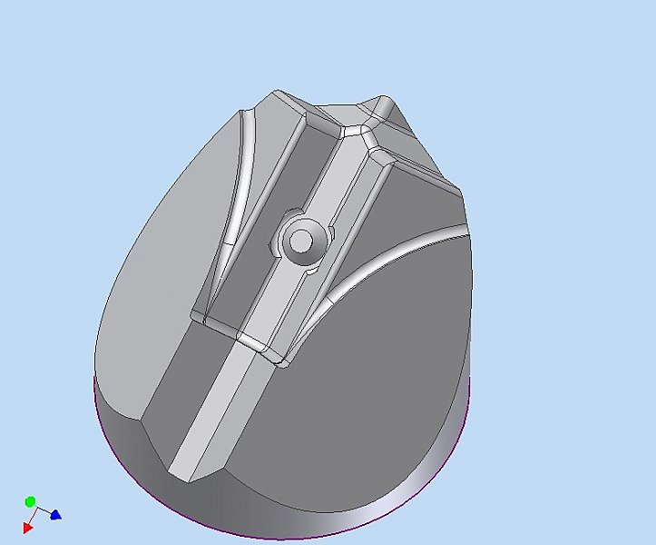

Well folks I think I've got it all under control.
The thick offset eventually excepted the 0 in surface mode but for some unknown reason I couldn't get the extrusion in the derived body, to terminate in both bracket & surface together, it was either on one or the other, (I tried both, surface created on the derived body and created on the ipt.) where as, by thickening the surface in the ipt, the extrusion in the derived part has flooded the body as wanted. See pic.
This bring a conclusion to this session.

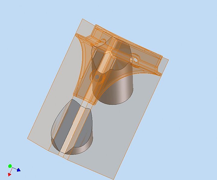

glad you got it all worked out ralf! Im not sure about the termination issue. You were using the From/To option and it was only allowing one or the other?
No I used To Next termination end selected the derived ipt which included the surface Tick Off set to0 and... No Sir, it would select either the ipt or the surface. It wouldn't allow the selections of both together.
In this pic is 2 extrusions To Next termination. As you can see 1 is on the surface the other is on the ipt. But could not get one in between the 2
It got me puzzling all the night how I was going to solve this thing.
Then decided to thicken the surface as a solid belonging to the bracket and that did the trick. Mind you the bracket used for the experiment was a derived one, the original remained untouched.
Following your last note I tried to use From To termination and as a result it would select only 1 facet. At least that is what IV 10 dose.
