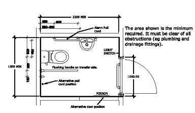

Pablo Ferral Posted March 26, 2010 Posted March 26, 2010 Sparkyuk, I don't have one, but all the information you need is here: http://www.planningportal.gov.uk/england/professionals/buildingregs/technicalguidance/bcaccesstopartm/bcapproveddocuments10 Tankman, I guess he means something like the attached... Quote

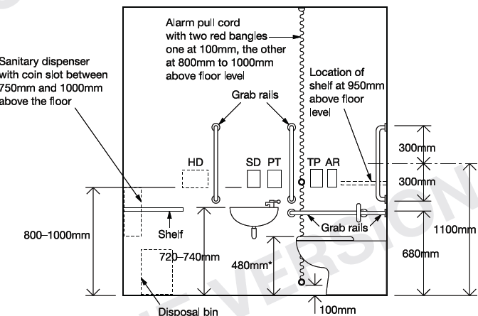

Tankman Posted March 28, 2010 Posted March 28, 2010 Nice one Tankman. How was that done? Did you trace over it? Converted the *.pdf to a *.dxf file. As you could see, lots of stuff gets ugly. Soooooooooo........you start cleaning the drawing up; i.e.: start with scale. Goofing off, I thought all would best fit in a portrait title block. Second drawing I posted. At times, tired of waitin' for a *.dwg file, I convert *.pdf. With a good *.pdf program, you can crop various files, convert 'em to AutoCAD *.dxf, save as a *.dwg. Kind of like a copy 'n paste routine. **Note** 1st image attached was cropped 'n sized for posting from the *.pdf I generated. This *.pdf didn't break down (or up) too badly. Be sure to look at the *.dwg file attached too! Hope the *.dwg file is useful this Sunday morning! Your file can be printed to a *.pdf, the *.pdf can be saved as almost any file type you like. The attachments here are seriously downsized (for posting) *.jpg's files of the drawing. I use Adobe Pro 8. DOC-M-Daft_Vader.dwg Quote
