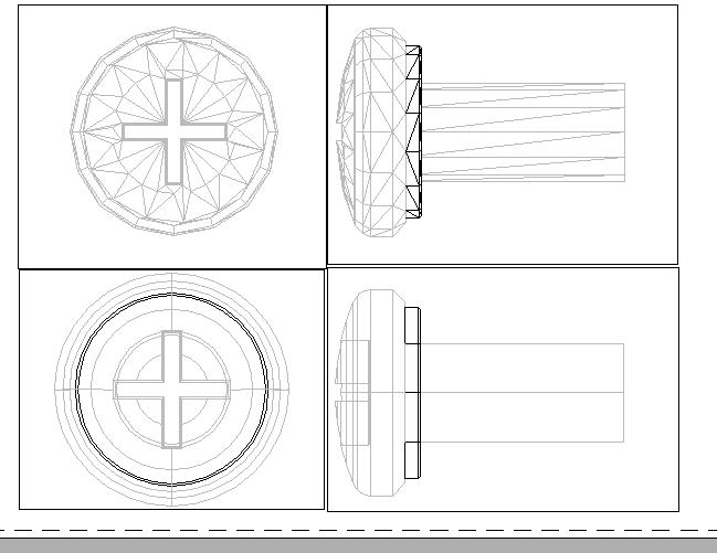

Crazy J Posted March 31, 2010 Posted March 31, 2010 Hey, this has been eating at me for a while now also... and I probably am showing great ignorance here. But the hide command, as in View/Hide or just typing Hide on the command line, this is different than the hidden button on the Shade toolbar or through the shademode command? It seems that View/Hide is just a temporary thing. Correct? Or does it have the ability to hide the hidden lines for simple paper drawings (prints) where you would not want the hidden lines showing? As I am littering up other posts with similar thoughts, I am in the midst of creating my first full drawing package after doing the solid model, and I can't seem to get nice clean drawings with hidden lines hidden or else shown as dashed as they should be. I just did the excercise you mentioned with a simple screw I'd drawn up. It hid the lines, but did that thing where it puts all the facets on it (or whatever that's supposed to be). Even if I did like the view that way, when I zoom in and out or do a regen it goes back to regular 2D wireframe. So, I guess my question then is, does the Hide command do anything of great value or permanence? And is there a better or proper way to efficiently treat hidden lines as they should be on a 2D print of a solid model? Thanks. Quote
Patrick Hughes Posted March 31, 2010 Posted March 31, 2010 The hide command will simply hide the non visible lines for viewing purposes. Is has no perminance, a regen of zoom will bring the hidden lines back into view. If you want to plot a "hidden" view you have to select that option in the plot dialog. There are times that some lines that should be visible after a hide do not show. The facets you see are controlled with the DISPSILH (Display Silhouette) variable. Quote
