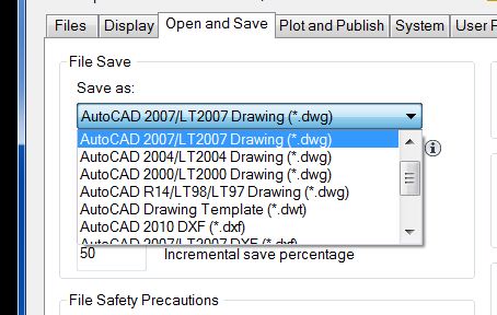

Car5858 Posted April 4, 2010 Posted April 4, 2010 When you use 2010 you need to save to a lower file format with "save as" select the drop down menu near the file extension. Select 2007 format or lower. You can also change this in the "Options" under "Open and Save Tab" You may wish to check your system requirements for DWG Trueview http://images.autodesk.com/adsk/files/dwg_trueview_2011_system_requirements.pdf Quote
