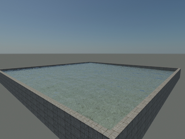

Hugh_Compton Posted April 6, 2010 Posted April 6, 2010 Hi Arno I've attached the Onyx.blue file. Sorry, wasn't aware that it was referenced in the DWG. I would recommend Max for rendering. I have attached a jpg that I just did in 2 mins using some materials that Max comes complete with. You can animate the material by using a simple noise modifier too. Quote
