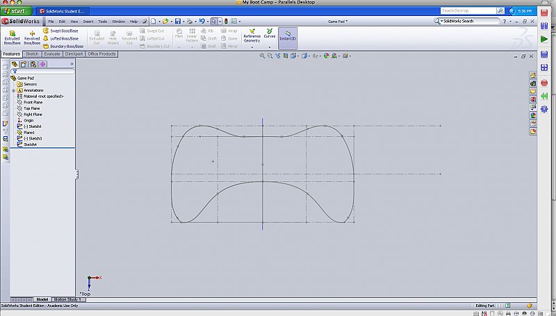

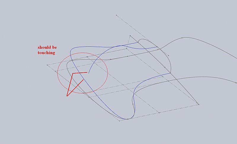

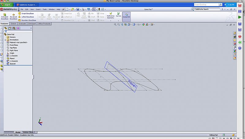

remycerri Posted April 7, 2010 Posted April 7, 2010 I have this really time-consuming assignment using solidworks modelling up a game pad. Could someone help me figure out why i can't add in a curve. Here is a screen dump - if it's not clear i can try and send through the PDF instructions. Rem. Quote

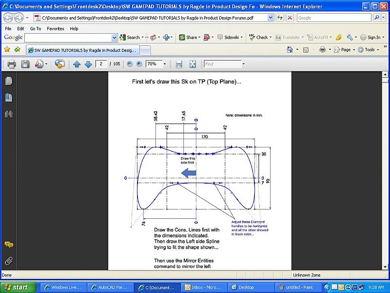

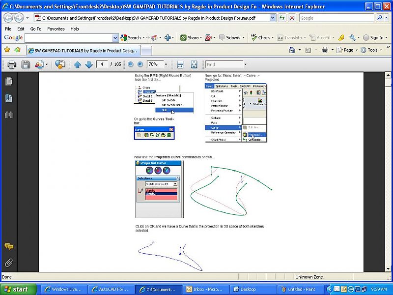

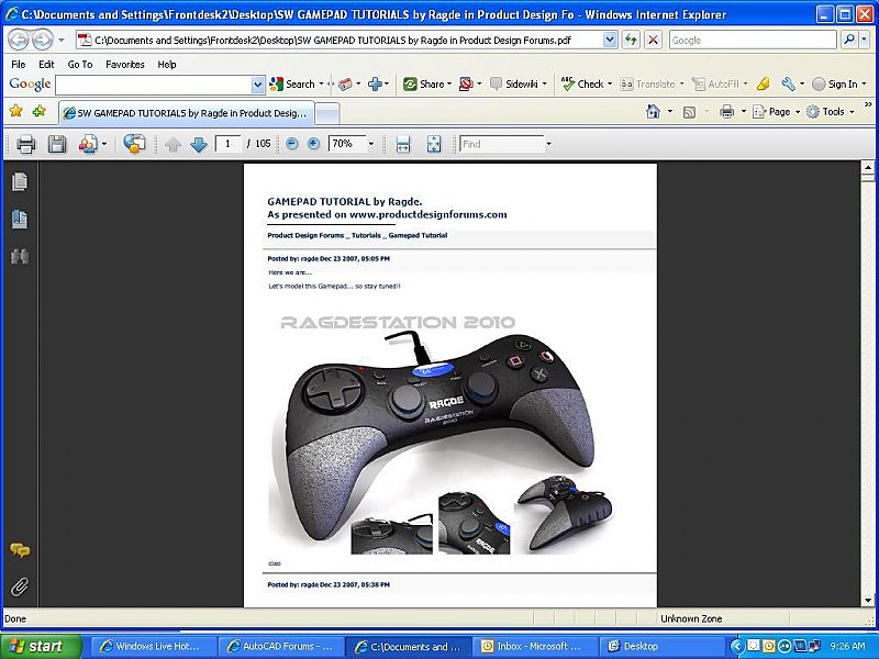

remycerri Posted April 7, 2010 Author Posted April 7, 2010 Here are the instructions i'm following, this might make it a little clearer... i'm up to the 3rd page trying to add a 'projected' curve to the drawing. Quote
shift1313 Posted April 8, 2010 Posted April 8, 2010 what error are you getting? Are you using Sketch on sketch for your projected curves? is your first sketch a closed profile with no open contours? I couldnt make out all of the specs but i drew something similar just now and it works fine. Quote
shift1313 Posted April 8, 2010 Posted April 8, 2010 also i noticed a problem with your drawing. The images you uploaded for the instructions show the origin centered on the drawing so your mirror centerline is across the origin. This means you dont need to create a plane for your second sketch. Also you have 3 sketches when only two should be there. whats on the 3rd? As a note in your feature tree, next to your sketches the (-) means under defined. Quote

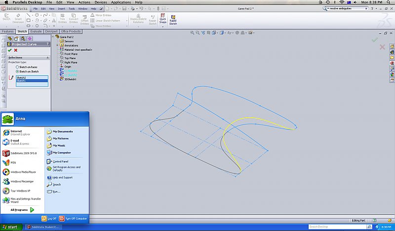

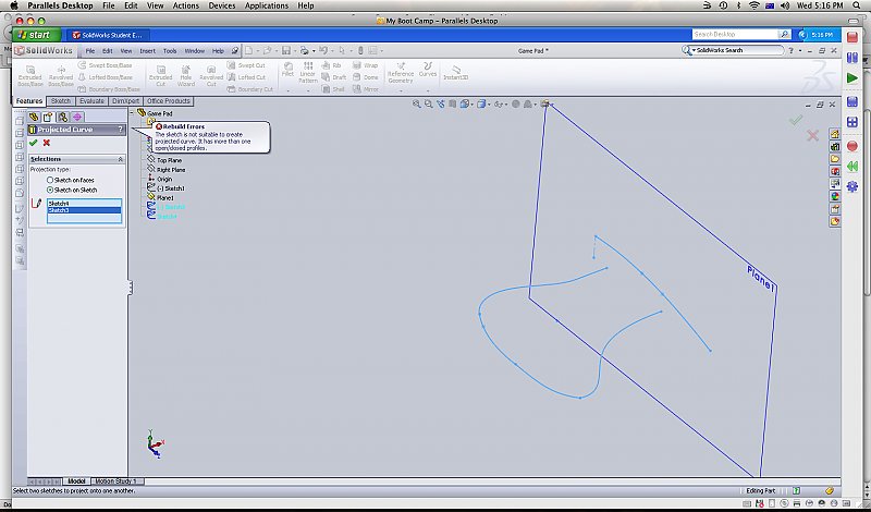

remycerri Posted April 10, 2010 Author Posted April 10, 2010 Oh now i understand why when i was trying to draw on the rp it wasn't starting from the centre of the sketch... i'll go back and draw it from the origin then. The error coming up when i try to add the projected curve is something like too many open contours... ? Thanks for your help by the way, my teacher is hopeless with returning emails! Quote
shift1313 Posted April 10, 2010 Posted April 10, 2010 Well the project curve looks for a single continuous loop in each sketch. If you have more than one you will get an error. So you need to make sure your controller half is one spline and there are no other lines in the sketch that are not construction lines. Quote

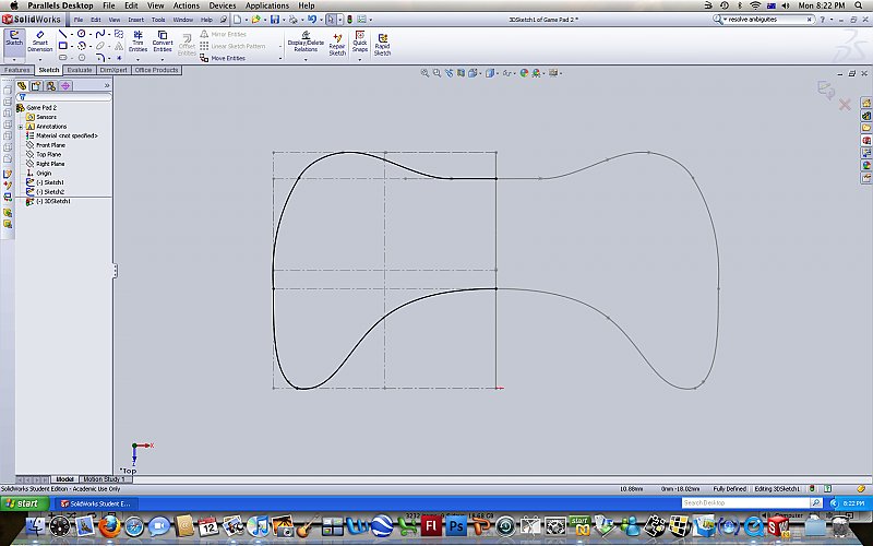

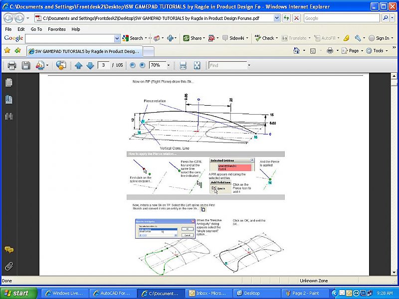

remycerri Posted April 12, 2010 Author Posted April 12, 2010 Ok so i've redrawn it now so the origin is in the centre and i have converted entities... it says something about 'resolve ambiguity' and then we are supposed to click single segment which is how im assuming you make it so its only one continuous spline... however this didn't come up on mine? how do i make it so its one continuous spline? Quote

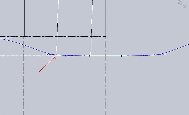

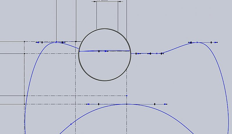

shift1313 Posted April 12, 2010 Posted April 12, 2010 which version of SW are you using? if its 2009 or older i can look at the files but if its 2010 i will not be able to open them. The issue with your preview of the projected sketch/sketch is because your spline is outside of your arc curve(drawn on the right plane). Even if its not noticable it may be a small amount. I found the tutorial online and took a look through it. This is some pretty advanced stuff. Is this what you are starting with? Or have you completed some other work. I will gladly look at your stuff/help you out but I would suggest starting with some more simple surfacing examples before tackling this project. Quote

shift1313 Posted April 13, 2010 Posted April 13, 2010 http://www.ragde3d.com/tutorial/index.php My main problem looking through the tutorial is that it just tells you every step to do and not really why or what you are actually doing. For such an advanced topic I don't think the point would get across to the user. So if you do something a little different you wouldnt see what the problem is since you don't know whats happening. Quote

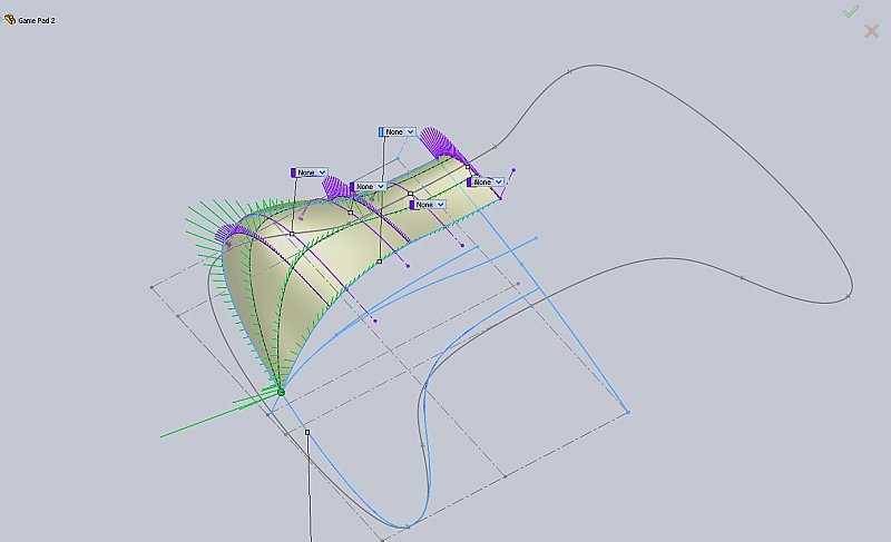

remycerri Posted April 14, 2010 Author Posted April 14, 2010 I know, the other lecturers have agreed it's an extremely unclear tutorial - and they have only given us a week and no class time as we were on holidays. Another class only has to do up to page 30! How do you use the PM system? Quote

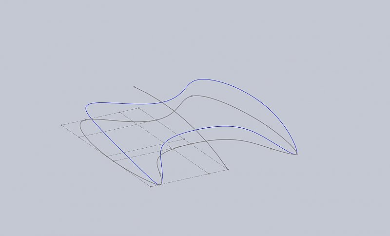

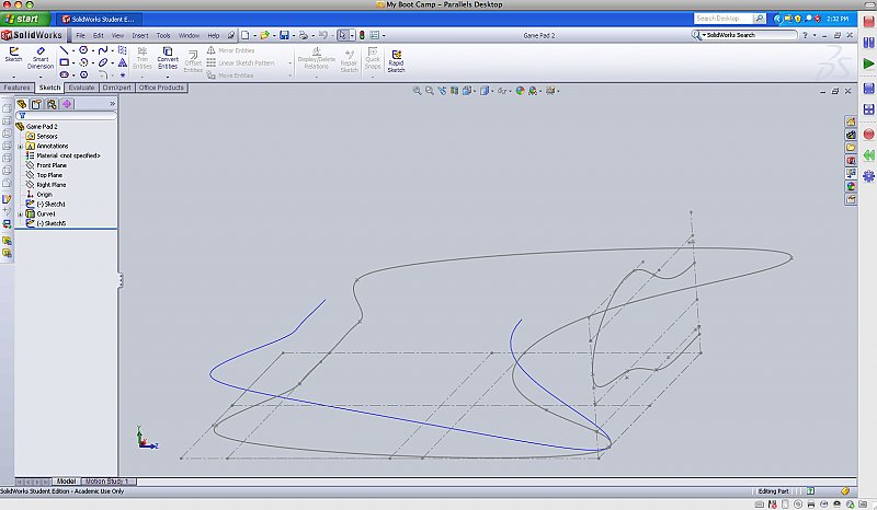

remycerri Posted April 14, 2010 Author Posted April 14, 2010 This is what im up to now... but i realized the origin is in the wrong spot again... how can i change this without having to redraw it all. Im up to page 5. It's not letting me send you a private message either!! Quote
