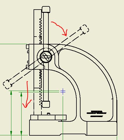

maybe you guys can help me with this. What's the role of Position then?
Are you referring to Position Representations.
Allows representations of assemblies with remaining degrees of freedom (motion) to be shown in multiple positions.
There are many different uses for this including Overlay views of position in drawing.
(just realized my arrow drawn the wrong direction, but you get the idea)
