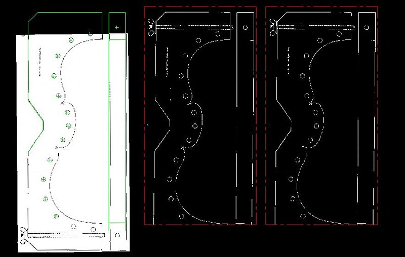

The image on the right is a jpeg, tif in the center and png on the right.
Depending on your back groung color viewing of it image is sometimes better with the png.
With the png I can sharpen the image to get fine lines, using a negative function in the photo editing software, will result in the lines represented with one or two pixles in width. These are easy to follow without worry from the distortion the backgroung of the image may produce in other formats.
Although this attachment is a jpeg image I hope you can see the difference. When I xref raster images into AutoCad they show up much better than this image.
