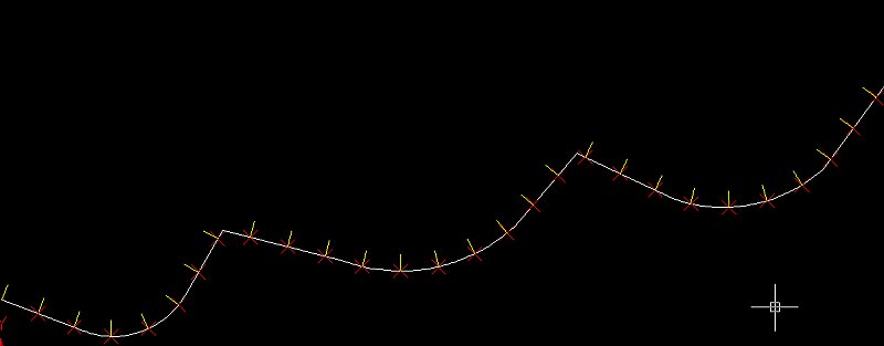

samcoozy Posted April 11, 2010 Posted April 11, 2010 Hi, I want to make a perpendicular line on given Poly line. How can I do this using Lisp. and I repeat this following given segment length. see example as attached white object represent my polyline cross divide our object into segments yellow lines are the perpendicular on my object(make these fexed length yellow lines using lisp). Thanks in Advance! —Sam Quote
alanjt Posted April 11, 2010 Posted April 11, 2010 You could just make a block out of the line and use Measure, but I've already compiled something that I think will work for you. http://www.cadtutor.net/forum/showthread.php?t=46309&highlight=copyalongcurve Quote
BearDyugin Posted April 11, 2010 Posted April 11, 2010 You could just make a block out of the line and use Measure If the task is over, I just think that fairly standard commands Measure Quote
alanjt Posted April 11, 2010 Posted April 11, 2010 There you go, Geobuilder even gave you a step by step example for Measure. If the task is over, I just think that fairly standard commands Measure Quote
samcoozy Posted April 11, 2010 Author Posted April 11, 2010 You could just make a block out of the line and use Measure, but I've already compiled something that I think will work for you. http://www.cadtutor.net/forum/showthread.php?t=46309&highlight=copyalongcurve Thanks a Lot!!! Quote
alanjt Posted April 11, 2010 Posted April 11, 2010 Thanks a Lot!!! No problem. However, I think I was a bit hasty in posting my Lisp routine. I would strongly suggest you follow my first and Geobuilder's suggestion and use, or at least learn to properly use Measure. I didn't realize you created this in the Beginners area. Quote
