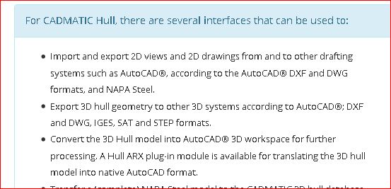

I'm using CADMATIC Hull (marine structure design software). I hope you guys know about this software.
Is that a .dwg format?
Looks to be Autocad compatible.
