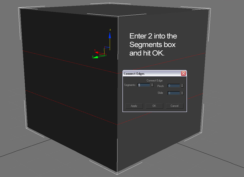

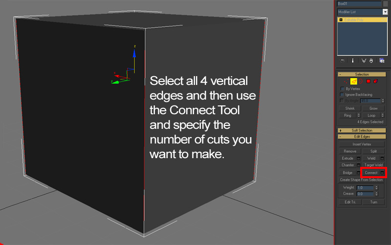

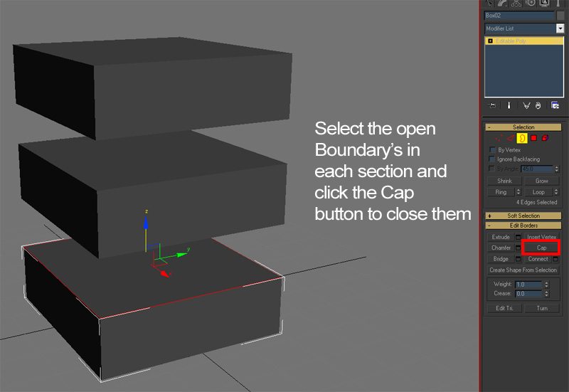

There are probably many different ways to accomplish this, and based on your object, some ways may be better than others. But here's an easy way to split a box up into 3 equal pieces.

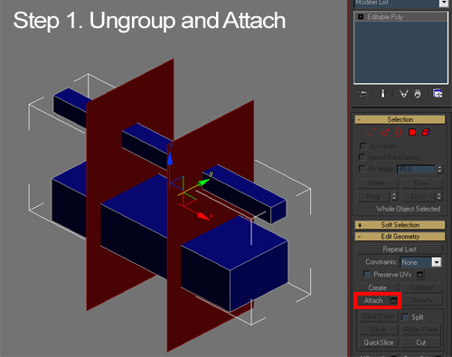

Here's what I want to do. Just to split the blue parts at the red planes
I can think of several different ways to do this, but one way would be to use a Boolean operation. You will first need to Ungroup the objects and then "Attach" them. You will "Detach" them after the Boolean. (Don't Attach the Planes).

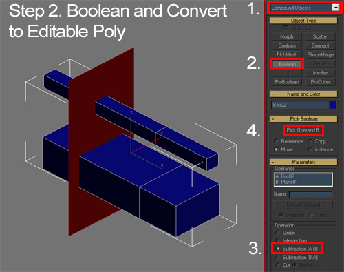

After you Attach all the blue parts, switch to Compound Objects, select Boolean, make sure "Subtraction (A-B)" is selected, click "Pick Operand B" and then select one of the planes.
Now right click, select "Convert To" and then click "Convert to Editable Poly".
Repeat the Boolean procedure and select the other plane. Then "Convert to Editable Poly" again.

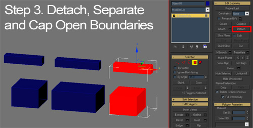

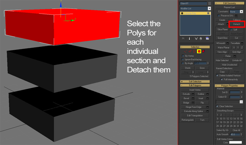

You can now select the Polys for each section and Detach them so you can separate them. Then just switch to Boundary selection mode and cap the open Boundaries for each piece as I discussed in my previous post.
