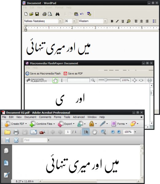

Did you try Adobe Acrobat Professional for PDF plotting? I think it should work for you.
I remember having a similar sort of issue while working on Microsoft Office. I had a few Word documents that were written in Urdu. The documents displayed the Urdu font correctly but when the files were converted to PDF, the words got "dismembered"! :lol:
I experimented with most of the free PDF converters, that I could find, but without luck. Finally, it was only Adobe's Acrobat Professional that could convert the script flawlessly, but unlike the other converters this one is not free... :glare:
I guess they have a trial version that you may try out... :geek:
