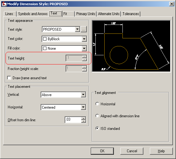

alanjt Posted April 15, 2010 Posted April 15, 2010 Mine isn't a good example since we have it set in the Textstyle (type Style) to be 0.1, but if set to 0., you can change it to something else. Quote
