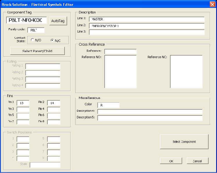

I would like to use VBA to select a block and have the attribute values populated on a VBA form. Then after Editing/changing the values on the form have the previously selected block updated with the new values.
I have been able to used some modified code from bsamc2000 in another post to read the block's attribute values and populate a form but how would I update the block with all the edited values from the form?

Try this (see 'Select Case' statement in VBA Help)
Option Explicit

Private Sub SelectButton_Click()
   Call Change_it
End Sub
Private Sub ChangeButton_Click()
   Me.Hide
   Dim AttList As Variant
   Dim i
   ' Change attributes for the selected block.
   AttList = oBlkRef.GetAttributes
   ' Cycle throught the list of attributes.
   For i = LBound(AttList) To UBound(AttList)
       ' Check for the correct attribute tag.
       Select Case AttList(i).TagString
       Case "TAG1"
           AttList(i).TextString = ParentSymbolForm.ComponetTag.Text
       Case "DESC1"
           AttList(i).TextString = ParentSymbolForm.TextBoxDesc1.Text
       Case "DESC2"
           AttList(i).TextString = ParentSymbolForm.TextBoxDesc2.Text
       Case "TERM01"
           AttList(i).TextString = ParentSymbolForm.TextBoxPin1.Text
       Case "POS1"
           AttList(i).TextString = ParentSymbolForm.TextBoxSwPos1.Text
       End Select
   Next
End Sub

For editing symbols using a custom form is much better then the standard Attribute Editor. I have attached a preliminary JPG of my form for editing electrical symbols. The Data I will need to change is presented in a much more orderly function and Attributes that do not normally require editing are hidden. Plus I will be able to add auto Tagging functions etc. to this form
