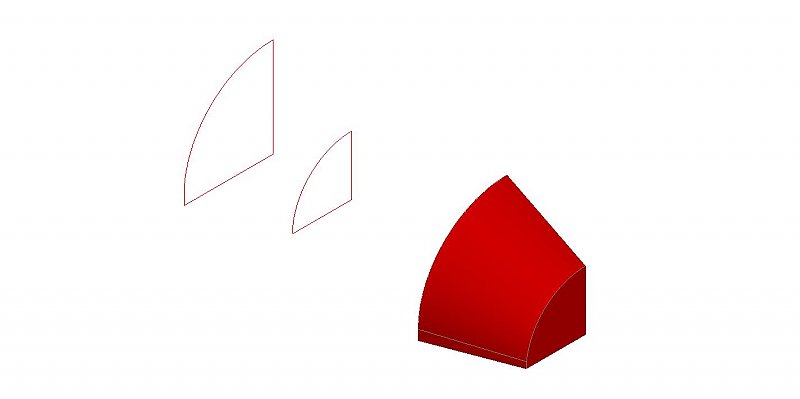

Alex0856 Posted April 19, 2010 Posted April 19, 2010 I've got the following shapes going: The pink one on the left is a combination of planar surfaces. The shape on the right is just a basic 3D solid. The the arrow is representing the radii of both edges of the shapes, meaning they are the same. The shape on the left is made of planars because I can't figure out for a damn how to get that into a solid - So I used the blue shape as a reference to create the pink one, using a ruled surface to get the top rounded piece. I've Google'd the hell out of this one - now I'm stuck. I need to make a 3D solid in the exact shape of the combined surfaces. Help please, and thanks ahead of time. Quote

JD Mather Posted April 19, 2010 Posted April 19, 2010 ... using a ruled surface to get the top rounded piece. Forget ruled surface - this one looks like a simple lofted solid solution. Attach the dwg here. Quote

ReMark Posted April 19, 2010 Posted April 19, 2010 Agree with JDM regarding the use of Loft to construct solid. Here is an example. The two profiles to the left were created with lines and then each profile was joined using Pedit. The result of the LOFT command is shown on the right. Quote
Alex0856 Posted April 20, 2010 Author Posted April 20, 2010 Thanks ReMark, not sure why I didn't think of that. I doubt you really want EXACT (looks pretty ugly to me) but in Inventor could be stitched. I think AutoCAD 2011 also has Sculpt tool. Looks like a simple file (no proprietary info) why haven't you attached it here? Looks ugly to you but it has its purpose. I do want exact, I said that for a reason, what's wrong with that? Didn't attach it because I wanted text instructions. Again thanks Mark, problem solved . Quote
