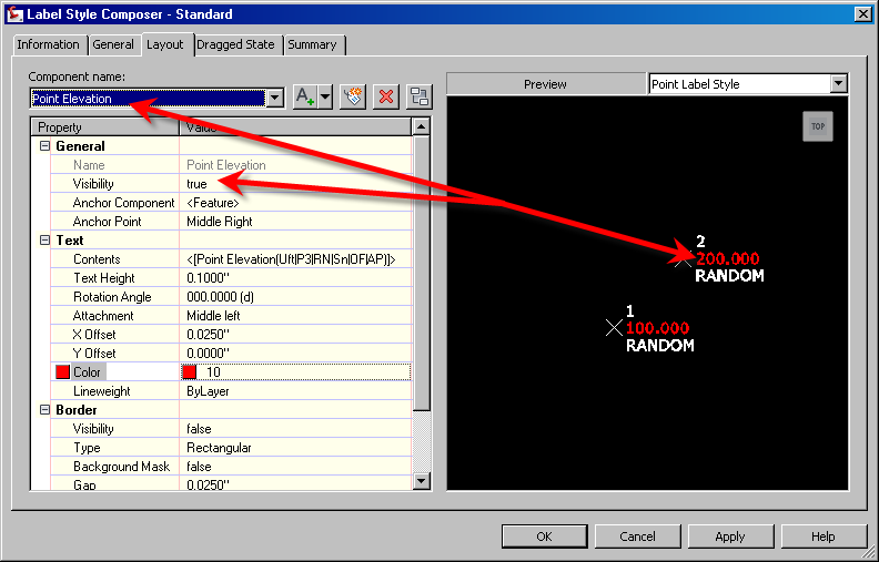

If you are trying to turn on the elevations on the points, you can either modify the point label style, or create a new one in which the elevation is visible.

You can also right click on the point, and select edit label, select the piece of text you want to add a comment to, and add it after the pre made text in the dialog box.

You can also right click on the point and select edit text, and add text, as much as you could possibly want really, to the label itself. Good for adding quick notes such as invert levels, soffit levels or any pertinent data.
