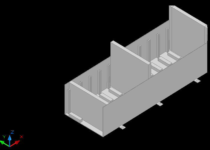

basically i have downloaded a 3d DWG file from the allen bradley website of one of their controllogix chassis (switchboard internal bits) and it is all in polygon Meshes. as best i can tell these seem to be some kind of 3d polylines? as i have tried help google and searches but i cannot see anything that tells me how, if at all possible, i might be able to make this a solid so i can export it to use in inventor.

i downloaded that lisp file from the autodesk site and just dragged and dropped it into cad as it says to in other threads etc, but when i type m2s into the command prompt this is what i get.
Command: (LOAD "G:/M2S-2007.lsp") nil
Command: Specify opposite corner:
Command: m2s
Unknown command "M2S". Press F1 for help.
i did notice on the file that it said 2007 does this mean this doesn't work with 2010? or is the issue that it is saved to a flash drive not the c drive?
the shapes i am trying to convert are a tad more complex then just redoing them in inventor also so that unfortunately isn't an option. :(
like i say i'm new to this side of cad and am sorry for the newbie questions.
ok so i downloaded a "newer" version that was ment to be better (but still 2007) and it atleast starts now, but after the first command prompt it cancels the m2s command and starts the area command. :?:
Command: m2s
Select a polygon mesh to solidify:
Enter desired thickness of solid below lowest vertex :
Point or option keyword required.
; error: Function cancelled
Specify next point or [Arc/Length/Undo]: _endp of
Specify next point or [Arc/Length/Undo/Total] : _endp of
Area = 1470.7941, Perimeter = 309.8464
ok i have just spent another hour looking for an answer to this. here is one of the files i have been playing with but i have some others that are FAR more complex. i have also attached the lisp file that atleast starts to work with 2010. maybe i am just doing something wrong here as i am a total newbie to this stuff.

:shock:ok some level of success!:shock:
basically
Step 1: i took the drawing into AutoCAD and exploded it. got rid of all things not line, circle, arc or 3d face related and saved.
Step 2: Opened drawing in MDT and exported it as an IGES file.
Step 3: Opened the IGES file in Inventor and i now have a whole lot of surfaces showing my model.
this is good enough for what i want to do with these files. however i would love to know a simpler way of getting this result if there is one.

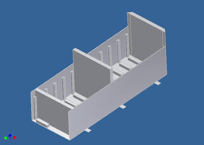

first let me say JD i haven't had the time to sit down and watch your video yet. was alot busier on the weekend then i anticipated (thanks to the little lady) :lol: i will endevour to do that tonight if i can. so i have a couple of questions as my client is asking for a better result then what i currently have and i don't have much time left on site. the other issue i am having is when i have these parts pattened in a model and when i try showning them in a 2d layout it is making my poor little laptop work HARD and going VERY slow. (have to have a chat to the boss about that. :lol: )

OK, so i now have this model into inventor and it looks (to me) like it is all surfaces. from the very small play i have had with it i understand that to stich things they have to be adjacent and the exact same size.
just looking at the model i can see that this is not the case in a whole lot of places. so i thought i'd give stitching it a shot in a couple of places that it looked right and try fill in some missing faces. i am now having 2 problems,
firstly;
stitching,
when i try and select the faces to stitch it just highlights my whole model and won't let me select individual faces or edges. not sure why. does this mean they are already stitched despite them not touching? or because i have imported it from an iges file does that mean it sees it as one whole part and i can't do anything with this?
when i tried the select all i got the following error;
Create stitch failed
Modeling failure in ASM. Redefine inputs.
Part2.ipt: Errors occurred during update
Stitch Surface1: Could not build this Stitch Surface
(not suprising) so i am assuming this means i need to "fill in the blanks"?
so i tried to "fill in the blanks" (missing faces) and that brought me to my second issue,
patching;
i am assuming that this is the comand i need to use to make the missing surfaces?
so i have tried to patch the missing bits and it will let me select the edges, however when i select some edges close to face joins/changes it will go past where i want/need it to. and unless i am holding my tongue wrong it doesn't seem to want to let me "unselect" the bits i don't want to use. does this mean there is again an issue with the imported model? if it does let me select only the edges i want it seems to create some wierd face in the midle of nowhere and touching only one (if any) of the selected edges. what am i doing wrong? or is this again a model issue?
i have tried just thickening the faces that it would let me use but keep geting heaps of errors. specially when they intersect. it seems very hit and miss and does seem to take a long time to thinnk about it before telling me no. (atleast it's considering my stupid requests i guess :lol:)

If you go a little further in AutoCAD. Convert the 3d faces to surfaces then thicken into a solid you can then export as .sat and import into Inventor.
You can work with it as a solid, however, it's still only a single part. I have the 2009 .ipt but it's over 2mb so not able to post here.
KC

:shock:ok i have had a play around with it for the last couple hours and i have total success! :shock:thanks heaps JD! that tutorial was exactly what i needed. i have learnt so much! just hope it sticks now!:lol:
I stitched it in Inventor CE and got many many parts, but not all. The model looked so simple that I would use Pattern or simply do a drawing for the dimensions and remodel the whole thing from scratch. Shouldn't take more than 30-minutes.
