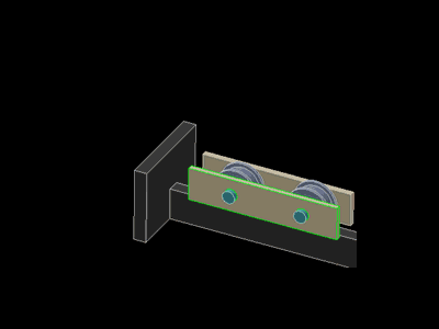

kjetilhansen Posted April 20, 2010 Posted April 20, 2010 Hi all. Im am sorry about not searching, but i dont know what to search for, i am not shure how to explanine my problem, but i am going to try. I am draving a homemade cnc machine, and the top marked whit blue is supposed to slide on the rail, and it does, but the problem is i dont know how to stop it to slide off.. i need it to stop when it hits the wall... Anybody know how? Thanks. Quote

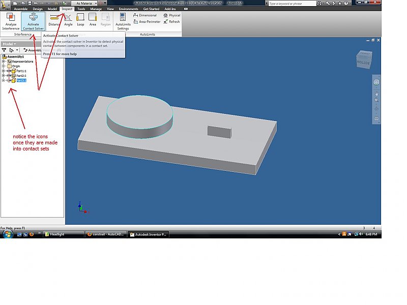

kencaz Posted April 21, 2010 Posted April 21, 2010 As Shift stated, contact solver is the way to go... Just right click on each part and select "Contact Set" Now you need to turn on the solver under "Tools" >> "Activate Contact Solver" as such: KC Quote

shift1313 Posted April 21, 2010 Posted April 21, 2010 Click on the part in your feature tree(right click) and select Contact Set. The contact set icon will appear next to the name. Once all the components you want are contact sets go to the Inspect tab and click Activate Contact Solver. Quote

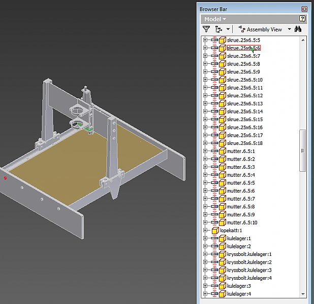

kjetilhansen Posted April 22, 2010 Author Posted April 22, 2010 Hi. I have tryed evrything now... i dont know if there is somthing wrong in my settings or somthing... I have added all my files in a .rar file as you said. Thank you for your help http://rapidshare.com/files/378842625/cnc_maskin.rar.html Quote

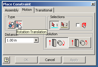

kencaz Posted April 22, 2010 Posted April 22, 2010 It's probably best if you just used a Rotation-Translation constraint then use an angle constraint to drive the wheel a set distance. This would be better for animating in Studio then trying to use the resource intensive contact solver. Just a thought. KC Quote

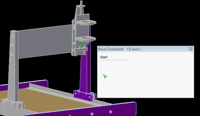

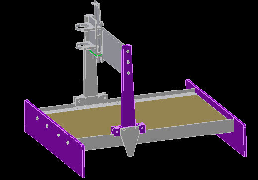

kencaz Posted April 23, 2010 Posted April 23, 2010 You added everything but the kitchen sink to that contact set!!! I removed all and added only what is in purple to the set and it seems to work fine. I still think it's better to just add transitional constraints that can be driven. KC Quote
kencaz Posted April 23, 2010 Posted April 23, 2010 Driven flush constraint... No contact solver needed KC Quote
JD Mather Posted April 23, 2010 Posted April 23, 2010 You added everything but the kitchen sink to that contact set!!! I removed all and added only what is in purple to the set and it seems to work fine. I still think it's better to just add transitional constraints that can be driven. KC Yes, add only what is absolutely needed to contact set as contact solver is resource intensive and part already (always) in contact can freeze the solution. Then turn off the solver once motion is verified. And as you indicated a driven constraint is more efficient. In fact, I generally only use Contact Solver when one motion has to intermittently move another part - not to stop motion. Quote
