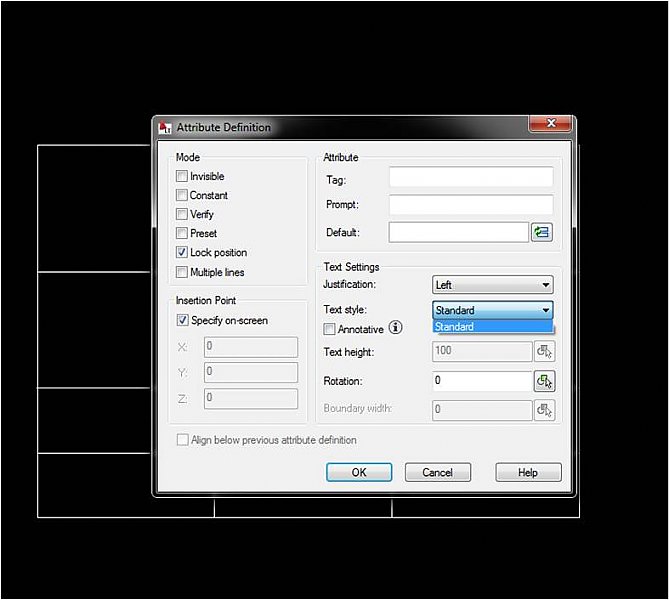

longweight Posted April 30, 2010 Author Posted April 30, 2010 Thanks Glen, I've got AutoCAD for Dummies in front of me and I have tried creating attributes but I just can't get it to work! It won't allow me to adjust the text height? Any ideas how to change this? Thanks Quote

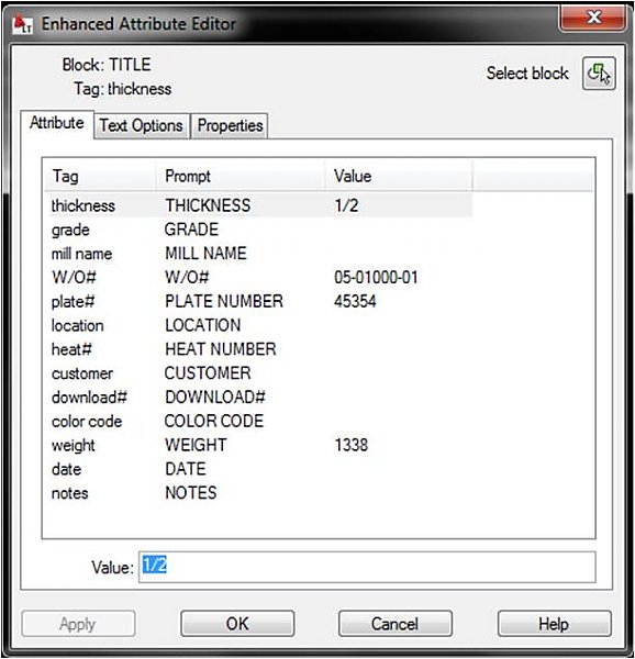

longweight Posted April 30, 2010 Author Posted April 30, 2010 Ok so its nearly there! Only problem I can see is that when I double click to edit the attribute it doesn't come up with the window shown in the image, any ideas as to why? Thanks for all of your help so far! Title block attempt2.dwg Quote
longweight Posted April 30, 2010 Author Posted April 30, 2010 I have changed the tags to be different but on the drawing I have just uploaded they are all the same Quote
Tankman Posted April 30, 2010 Posted April 30, 2010 I often play with title blocks, my work is simple, thus I don't need much. There isn't any need for me to use attributes. I do 'bout the same stuff everyday. Don't forget to save the titleblocks as *.dwt files. PORTRAIT-TITLEBLOCK.dwg LANDSCAPE-TITLEBLOCK.dwg Quote
Glen Smith Posted April 30, 2010 Posted April 30, 2010 You need to do an ATTSYNC to synchronize your attributes, that should get things to the way they should be. Check what the ATTDIA system variable is set for also and report back. Glen Quote
tzframpton Posted April 30, 2010 Posted April 30, 2010 I personally don't use Attributes. I use a block that's on a locked layer, so it easily updates across multiple layouts when updating (other than individual sheet specific information). Quote
longweight Posted April 30, 2010 Author Posted April 30, 2010 Ok I have run the ATTSYNC command. The ATTDIA command is set to 1? Quote
Glen Smith Posted April 30, 2010 Posted April 30, 2010 Open a new drawing and insert your block. Double click on at attribute that you want to change and it should open the attribute dialog box for you to make changes. There are some text fields in there as well, double clicking on those will edit the text, but they are not attributes. Glen Quote
longweight Posted April 30, 2010 Author Posted April 30, 2010 Thanks for all this. Its the table ATTEDIT brings up, is there a way to make it come up with that table when you double click instead of the table EATTEDIT that I get when I double Click? Quote
