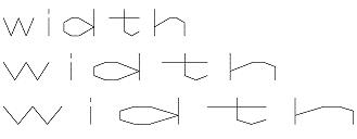

I have 1/8" high string text that was had .8 inches width. My text in my dimensions did not have a width factor. When I hit properties for a selected dim I did not find a width setting.
So I was wondering how to set the width of the dim text to match my string text?
Assuming the dim text height & text strings had the same height.

From whence cometh the text style, font, width, etc. that you use when you dimension? Does the answer Text Style ring any bells?
Maybe I'm missing something here (usually am), but when I change the width of dimension text, I Highlight the text and change the width factor within the text formatting box!!
width.dwg
If you still need some help on this, try the EDIT command on the selected dimensions. From there you can use the MText Format Dialog Box to change the text width.

Can you not just type ED and then click on the dimension, change from there. Is that what you want.
Dodge 8)
Express tools>text>text fit
Simple enough with express tools if you want to stretch text.
