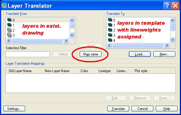

If you want to make the lineweights of the objects Bylayer, you can make a "template" from one of your existing dwg and edit the lineweights of the layers in the layer manager. Then use the Laytrans command.
In doing this....will it just translate the LW's or will it translate all the layer properties? Seems that all we need to assign are the lineweights....allowing all the other layer settings to remain as they currently are in each individual drawing.....does that make sense?
