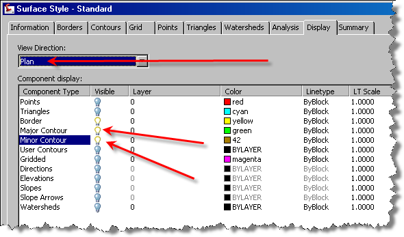

I did that but nothing happened the contours donts show up!! I dont have any styles so i created a new one with typical options.. do i have to change something there??
Check your style again.
On the Display tab, set the View Direction to Plan (for viewing in WCS), then make sure the two contour components are set to Visible.
Thank you so much.... that was so simple:)...you really helped me.....
