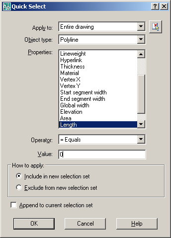

How would you go about filtering out and finding a zero length pline ??
I have several drawings converted from Microstation and when I run Eduard's "FLAT.lsp" to flatten the thing, I get a zero length PLine about 25.563245e27 ... long distance away that reduces my drawing to two dots on a black screen.
I want to add a piece of code to the end to simply filter out and find that one stupid pline of zero length and delete it.
Any help would be appreciated. Thanks.

I didn't think about QSelect until I had already coded this, and I notice Lee already did one, but since I took the time, I'll post it anyway.

Lee, I see we went the same route for filtering to avoid converting to vla-object. :)
Now that is interesting Alan, ... what does the DXF code (90 . 2) refer to ??
I can't find anything regarding this other than a 32 bit integer.
My PLine DXF code reads (90 . 22) ?.?
I like the way you guys think so much alike, but so differently. I just wish I knew half of what you guys know already, I wouldn't have to bug you so much.
dxf code 90 is the number of points it includes. Even a zero length LWPolyline will have 2 points. I just thought I'd ignore all LWPolylines with more than 1 segment from the start, just to make things a little faster. :)

I know a PLine can have more than 1 segment and have a zero length, but when such things are created, they are single segment, zero length objects. Which is the only reason I added that filter. However, it could easily be removed.
