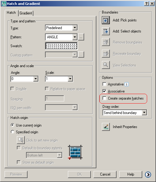

I just tried it, and when you create the Hatch there is a tickbox at the bottom right which says Create Separate Hatches, tick that.
That tickbox is also there if you Edit Hatch (double click on the hatch) but is now called Separate Hatches.
Sounds like you created the hatch as one object instead of multiple. Thankfully it's an easy fix.
Double-click on your hatch or type HatchEdit and select the hatch then check the Create Separate Hatches option.
[ATTACH]19264[/ATTACH]
When I enter hatchedit my dbox doesnt have Separate Hatch or anything that appears to give that option. Is there another type of fix? Thanks again

ahum... not an option in 2000 and/or LT then, too bad.
If you can't explode the hatch, that I think your out of luck and have to do them all over again, and do the hatches one at a time. :(
