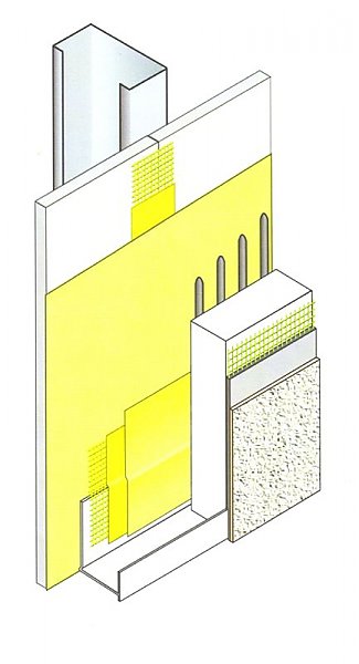

I'll need to draw a meshes of different thicknesses as shown on the attached image.

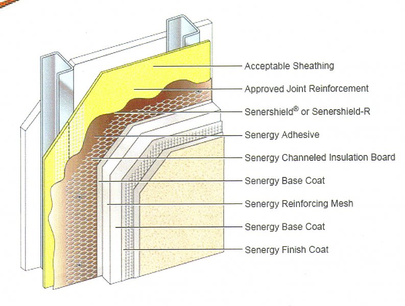

Also some components of the wall assembly have negligible thickness, and some are even fluids lapping between two parallel planes (see second image). I would like to be able to represent the fluid with a curvilinear boundary as shown.
What's the best way to draw these in order to facilitate later tweaks? I had originally been extruding 2D profiles of the surfaces, but find that there is no functionality in the resulting surface and had to redraw them as the development of the detail progressed. I had considered using regions, but suspect the same limitations. Ialso thought about drawing and arraying a tile block, and also wondered if there is a material I could apply to the face of a plane/region/solid. I expect to hear that I should be using 3Dmesh (seems fitting). Any guidance on how to make these resemble the image would be very much appreciated.

Negligible or not, they still have a thickness, so try drawing it accordingly.
If you want to render it, you could use custom materials to... hey.. didn't I suggest this to you already? lol
Hatching would do a surface too, but as far as my version goes, it won't render a hatch.
Good luck, maybe someone else has a better idea for you.
i would draw them as solid sheets and use materials on them. Your system resources will thank you.

Any time you throw a lot of features like perforated sheets, mesh, expanded steel and so on, they really hog memory resources so unless there is a very good reason to do so, applying a material to the face of a solid(or surface) is the way to go. This is the same reason we dont typically model threads in holes or on bolts unless you need to render a bolt. The extra feature really drag a model down and make the file size huge!
