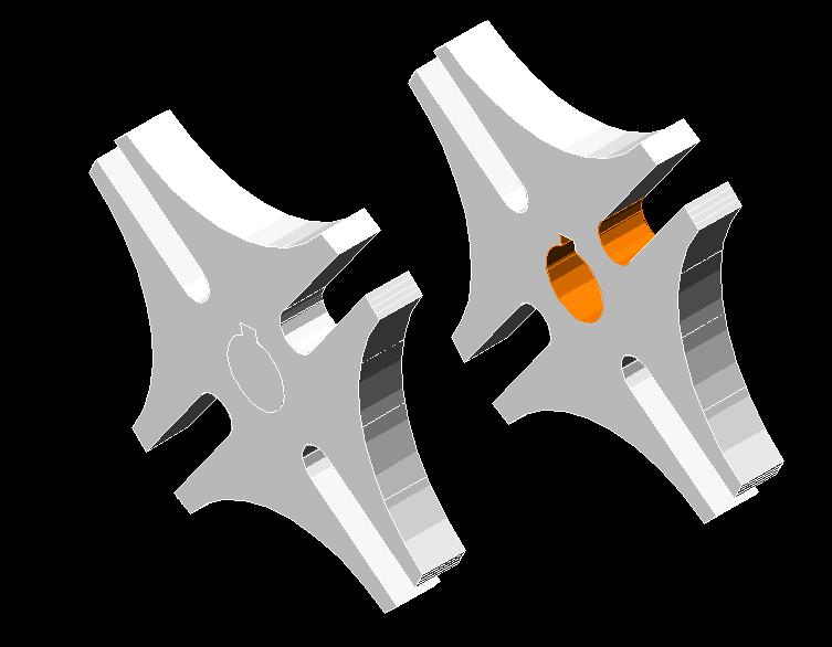

SFG13 Posted April 27, 2010 Posted April 27, 2010 Hi, I have an object that I want to change it's view to make it look similar to the ones in the picture below, can it be done? 4-22-010 1.dwg Quote

SFG13 Posted April 27, 2010 Author Posted April 27, 2010 Definitely ReMark! I tried using different views but it wouldn't come out the same. I even tried moving the UCS but can't get it close enough. Quote
ReMark Posted April 27, 2010 Posted April 27, 2010 You're on the right track with the UCS but I'll give you a hint. The key (the pun is intended) is to look at the keyway in the center of the object. In which direction is it pointing? Up...right? Quote
ReMark Posted April 27, 2010 Posted April 27, 2010 The second hint, which is really no hint at all, is to change the orientation of your UCS. You want "Y" to be pointing to the top of your screen. My question to you is which way will "X" point? Will it be to the lower right-hand corner, upper right-hand corner, upper left-hand corner or the lower left-hand corner of your screen? Quote
SFG13 Posted April 27, 2010 Author Posted April 27, 2010 Lower right hand corner, except the keyway is pointing lower left? Quote

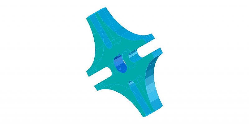

ReMark Posted April 27, 2010 Posted April 27, 2010 I've reproduced the orientation but my X axis was pointing to the upper right hand corner of my screen not the lower right hand corner. Sorry. Here is the result. Almost 7 p.m. where I am. Gotta run. I have the latest episode of 24 on my DVR and I'm dying to see it. I'll check back later if I have a chance. I know you can do this. Just keep that keyway pointing to the top of your screen. Good luck. Quote

ReMark Posted April 27, 2010 Posted April 27, 2010 So, do we have a winner yet? You could also try using the 3DRotate feature of AutoCAD. Quote
ReMark Posted April 28, 2010 Posted April 28, 2010 Another view of your object with the UCS visible. Required changing the orientation of the UCS then rotating the object 90 degrees. Quote

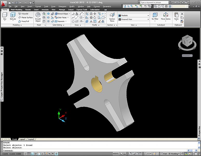

SFG13 Posted April 28, 2010 Author Posted April 28, 2010 Hey ReMark, I used the 3DRotate that you suggested, although I had some difficulty manipulating the angles and getting just the closest position I could but I would say I'm satisfied with my results. I've seen other student's work and the position really doesn't have to look exactly like the professor's but as long as the objects are correct. Thanks a lot for the help! Chesk it out! 4-22-010 1.dwg Quote
ReMark Posted April 28, 2010 Posted April 28, 2010 SFG: I'm not your professor and "close enough" is not good enough in this case. You should strive to get it exactly as shown. Close enough is OK for horseshoes and for those who are taking the course just to earn the credit. If you want to be the best then close enough shouldn't even be a part of your vocabulary. Please give it another try. Start with your original plan view. Forget 3Drotate for the moment. Type: UCS > X > 90 Type: UCS > Y > 90 Now relocate your your UCS by typing: UCS > O (for Origin) and when prompted select the endpoint of the leg opposite the red "X" axis you see in my image above. Type: Rotate. Use the Origin of the UCS that was just created. For the angle type in 90. The result should match the above. Then start all over again and do it a second time. But before you do make a second copy to use for your final task which is next. Finally, see if you can achieve the same result using 3Drotate on the copy you made previously. I believe you ARE capable of doing this. Go slowly and methodically and you will achieve the desired results. Quote
