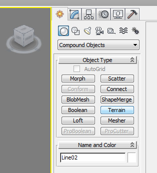

diggers Posted April 30, 2010 Author Posted April 30, 2010 Hi cad 64, thanks for the promp responce, yes I have seen this tutorial. And i thought I'd hit the jack pot. But I hit my first snag when it comes to clicking on "AEC Extended" - I dont not have a "Terrain" button, all I have is - Foliage, Railing and Wall to choose from. I have a friend whos helping me with the texturing, adding trees, and rendering etc, but as hes a building architect he's never had to ues a lot of contours, as I am used to using, and were both struggling with it. Any suggestions would be great. Cheers tom Quote
Cad64 Posted April 30, 2010 Posted April 30, 2010 I hit my first snag when it comes to clicking on "AEC Extended" - I dont not have a "Terrain" button, all I have is - Foliage, Railing and Wall to choose from. Ah, ok, that's because it's not in the "AEC Extended", it's under "Compound Objects". Quote
diggers Posted April 30, 2010 Author Posted April 30, 2010 thanks a million, found it. This should keep me occupied. Cheers mate Quote

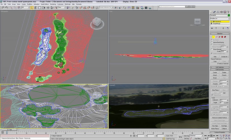

diggers Posted May 17, 2010 Author Posted May 17, 2010 Cheers Cad64 I only have points on my surface, when I go to edit mesh, on the chosen terrain. I thought this was the way to modify my surface? but when I do this I notice theres tons of points, especially around the edges of the terrain. Am I doing something wrong here? I've attatched a screenshot. Also to mention the file size is now at 50mb, do you think Im doing something wrong? thanks again for all your help. Quote
Cad64 Posted May 17, 2010 Posted May 17, 2010 No, it doesn't look like you're doing anything wrong. From what I can tell in the screenshot, that looks like a normal terrain mesh. Quote

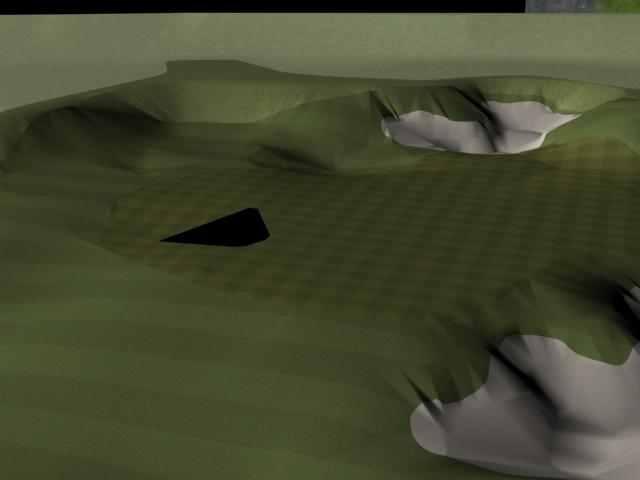

diggers Posted May 19, 2010 Author Posted May 19, 2010 Cheers And is it possible to reduce these points by deleting them? Because when I render the picture there seems to be a hole in the model, Ive attatchd a pic, I was also wondering if there was a command to take a delete points within certain parameters? Or a command to make the model smoother?? As you can see my sand edges are very triangular so to speak. Thanks again for your help, any suggestions re more tutorials so that im not bothering all the time lol Quote
Cad64 Posted May 19, 2010 Posted May 19, 2010 If you delete a point, it will also delete the edges attached to that point and either create a hole or a flat spot on your mesh. The best thing to do is make sure your contours are simple, clean and continuous in Autocad, before you import them. If your contours have a lot of points on them, or breaks in the lines, this will cause your mesh to be more complicated and problematic in Max. I haven't got time to create a contour map and play around with it right now, but there are controls in the Terrain modifier rollout that will allow you to adjust and simplify the mesh. And you should be able to smooth it with the Meshsmooth modifier. I don't know why you have a hole in the mesh though. I would need to have your file in front of me to figure that one out. It could be due to a problem with your CAD contours? Try searching Google for Terrain tutorials: http://www.google.com/#q=3ds+max+terrain+from+contour+splines&hl=en&sa=2&fp=c78e48b898b2787e http://www.google.com/#q=3ds+max+terrain+compound+object&hl=en&sa=2&fp=c78e48b898b2787e Quote
diggers Posted May 20, 2010 Author Posted May 20, 2010 thanks mate, the hole in the mesh was caused by deleting that point. Cheers for your help. Diggers Quote
