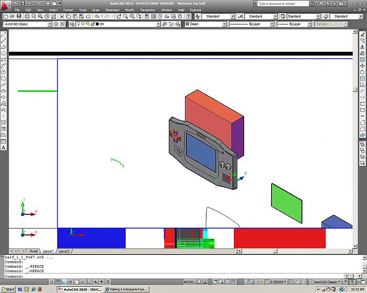

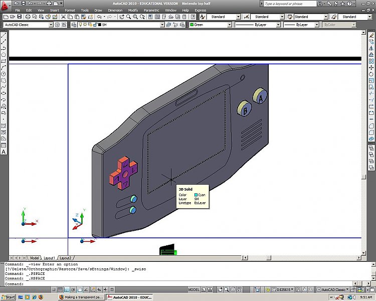

Here is a picture of my piece, the selected section is where the panel is supposed to be placed. Please see the attachment.

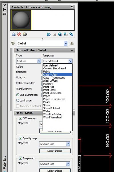

Make a rectangle(then extrude) for your panel then create a material for your transparent panel.Maybe adjust the color of the material lightly so that it will be visible enough to identify that its there.
I have attached a picture to guide you where you will be going.
I created a rectangle and extruded it like you said then I created a material to make it the transparent panel and are you supposed to render something after you apply the material to the object to allow it to be see through?
Yes.Have you tried rendering a scene yet?if not just type RENDER. Post some screenshots after the render so we can help you with some problems you'll encounter.

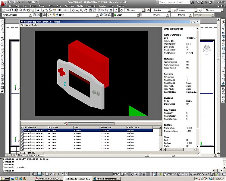

I just rendered the scene and it turned out be successful; and I am also playing with the translucency to make it more realistic. How does this look to you ?
Try adding a ground and use sun light so it will look much better.Not bad though.
Yea I agree, I plan on doing that a little bit in the future once I finish the rest of the piece. I appreciate your help on this topic.
No problem. Glad to help someone today.
